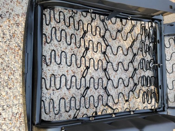

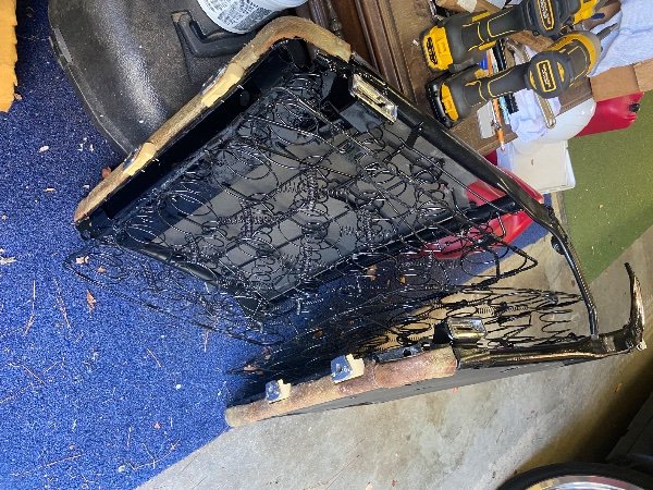

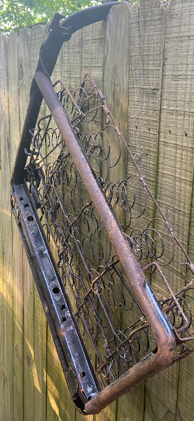

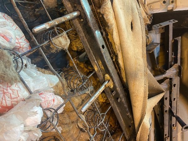

does any one know if 67 plymouth fury 2 door bench seat's have the same coil springs as a 68-70 roadrunners?
I'm restoring my 68 bench seat and it has turned out a little rusty...a few rusty and broken springs etc..
I have access to a junkyard bench but dont want to get if they are not the same. any ideas??
Which springs? Bottom or back
Probably the bottom. Be advised, years, 4-door, and 2-door seats can all be different. Had the same issue with the front bench in my Dart. After finding a donor bottom bench from a different year and a 4-door, yeah, the springs were different. I modified them to work. Spaced the 2 of them out, they were now of different tension. After sandblasting and paint, I tied the springs together with tyraps to help spread the load.
I still have some bottom springs, they may work or your find springs may work, look closely to see if they are the same.
Where is gods country located? I'm in Illinois.
I think all of the round one in the center are the same and all of the perimeter ones are the same. If you have one for parts just pay attention where they come from. I think the 4 door seats are different.
Thanks, I assumed they were similar, but I tend to assume alot..
