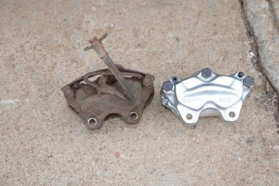

Calipers, on the other hand, are extremely hard to find. I have them on m'68 GTX and, in 20 years, I've only been able to find ONE caliper.
The A-1 Cardone calipers DON'T fit right out of the box.
Everyone sells them as a direct fit but the ONLY thing that's direct fit are the two attachment bolt holes.
The mounting bracket for the steel brake line cannot be attached to these metric calipers. (Yea, the bolts are all metric tread)
You CAN weld a 5/16" nut to the heads of two of the caliper bolts to attach the steel line bracket and they'll function but they're not an easy caliper to install.

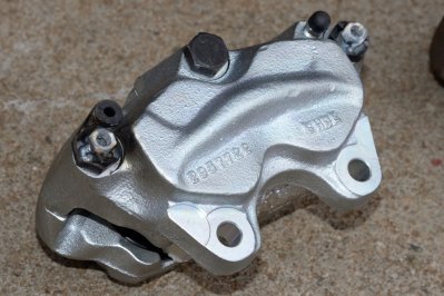

stock Bendix vs. aftermarket metric caliper

Stock Bendix on the left and the modified aftermarket metric caliper on the right
