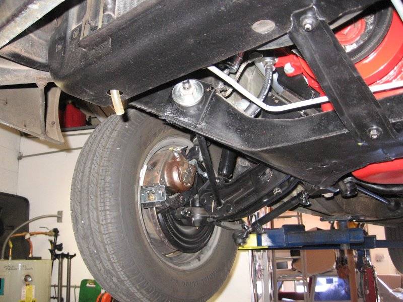

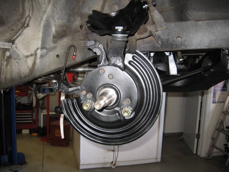

Photos are 80's Dodge Diplomat parts.
Yes, Reuse the upper and lower control arms of the 62.Spindles can be bought new (Summit, Jegs)or used. All other parts are for a 80" Dodge Diplomat and can be sourced at local auto parts stores.

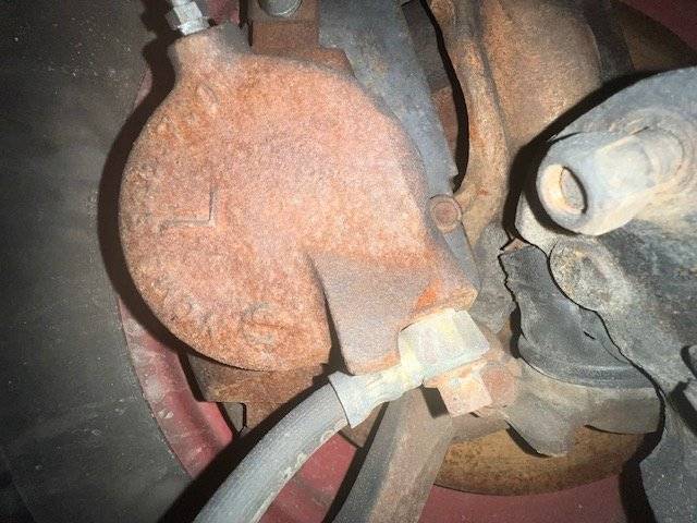

Show us what you have now. We may be able to tell the year(s) for calipers and rotors if that's all you need.
thanks for the info, the caliper on the car does look similar, here is a pic of the caliper
Looks like the pin type caliper from the 70's. I think thats what I put on my 70 Challenger when I did the disc swap. Used the 73- a-body spindle, Cordoba caliper, caliper mount and rotor. Could also use the slider caliper from the a-body and some others if I used the corresponding caliper mount. Great units, easily sourced service/wear parts.
Thanks for the help, I will get one and see if it is a match
