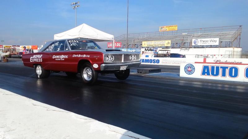

What benefit ( Best Wheels Up.jpgfor a drag race car only...nothing to do with a street/strip car) does removing the primary power valve on a Holley and then jetting up the primary side of the carb.

PS: Working on the final tune on my new 505" .... mainly jetting and timing now, no traction problems...1.55 60' with front wheels up and NO breaking loose on the slick. My 1.55 60' is close to my target of 1.50 60' to end up with a 10.80 at 123-125 Qtr Mile time....but not jetted or timed right yet....Running 34 degrees with 50/50 mix of 91 pump and VP 110 for a net of 100 Octane.
Has run a 10.98 at 120.6 on the 5th run...
