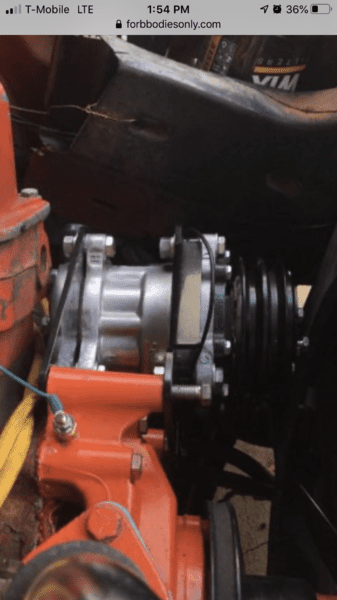

The brackets I have mount where the power steering pump goes and shouldn’t affect the air grabber set up. It from Bouchilion. I don’t think I spelled it right.
