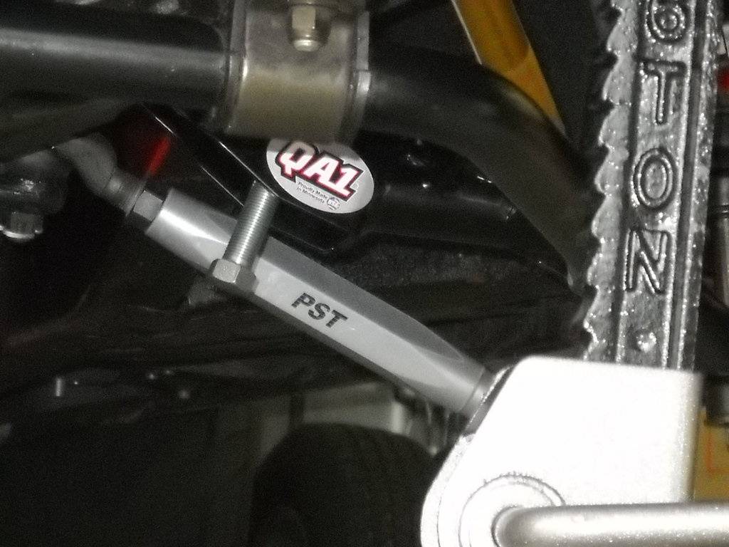

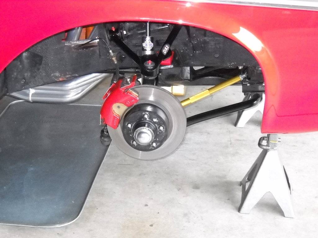

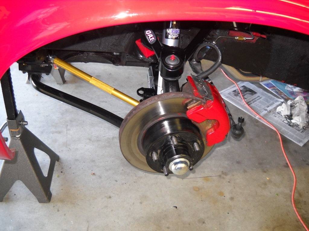

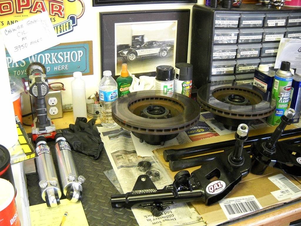

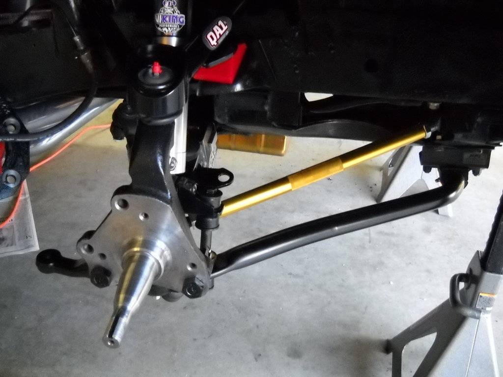

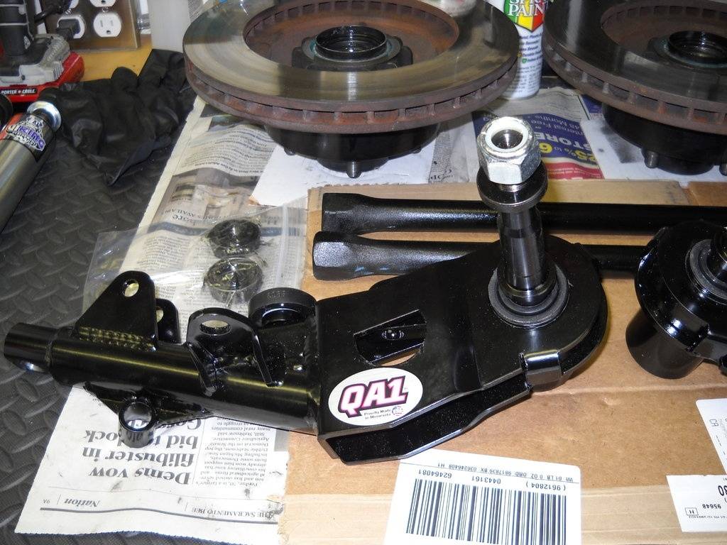

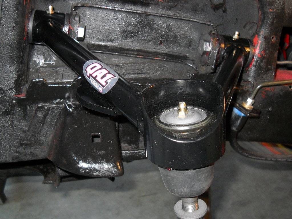

I just installed QA-1 tubular uppers, lowers and their adjustable strut rod along with new torsion bars and Viking double adjustable shocks. I did purchase the larger tie rod ends (11/16")and aluminum adjusters from PST. Along with a Firm Feel front sway bar, I'm very happy with the quality, fit/finish and overall handling and ride of the components.

QA1 lowers

SPC fully adjustable Uppers
