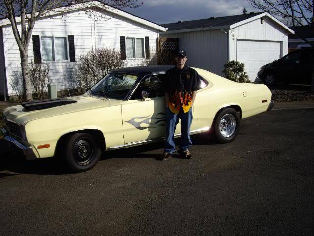

I too was nos junkie.
The Dust around are house is known as the spare parts car.
Just put together with spare parts.

Not that it makes much since,But of the 3 A-body's the Duster is the funnest one to drive.
