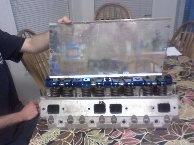

i agree with Meep-Meep, a little more compression will get you where you want to be. A set of closed chamber 915 heads with upgrade to bigger valve- (2.14-1.81) should do it, and if you search you might find a decent set at the right price. Or you could just spend the money and buy edelbrock heads-(closed chamber) and be done with it. Either way you will need the super stock springs and pinion snubber to get it to hook.

A wise old professional engine builder once told me, there are 3 things to know about when building racing engine & do them in this order, #1 CYLINDER HEADS PORTING, #2 Cylinder heads Flow Rates & valve seal, #3 cylinder heads parts/component improvement/lightening, the heads are the most important single performance parts change you can do, to make better HP/TQ, think of them like the lungs of your engine, it needs to breath, or it won't run to it's potential... But also don't forget the chassis it's equally as important, especially lightening it up, were ever you can, it's all about "power to weight ratio" after all, lighter is better & easier....

I agree with 383man the Stealth heads would be my number one modification at this point. The engine combination looks great accept for the stock heads. Make sure when you buy the heads to raise the compression by a point or so. I would not run any lower than 10.5:1 with an aluminum head motor. My pump gas 512 will be around 11:1 compression with Stealth heads. The suspension upgrades will be needed after the change, good luck.

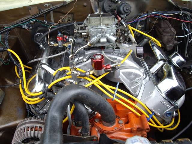

How much juice are you running on that thing? I was just looking at the the plumbing for your system. What kind of fuel system are you running? You may want to get a regulator for the nitrous side of the house. You probably know this already but the nitrous system needs 5 psi of fuel pressure and the engine will need 7 psi. Regulating the pressure will help you tune the system for optimal performance. I had a freind that was having problems of the car falling on its nose when nitrous was activated. Problem was to much unregulated fuel pressure. Hope this helps because I surely do not want to see a detonation problem for you.
