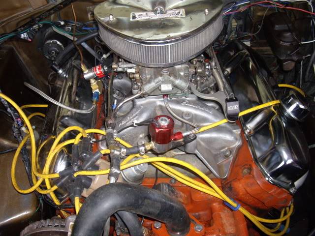

This use to be are trainer car.
Stock 1978 440 bottom end.
Ported 906 heads.
Eldelbrock Perm RPM intake.
780 Holley carb
Schumacher headers
Mopar solid 557 cam
727 trans-brake trans.Not using the brake for traing.
4.10 gears
Car ran 11.59 with this combo.
Nitrios on but not used for 11.50 pass.
Very mild on the street.
Runs on 91 octane.
