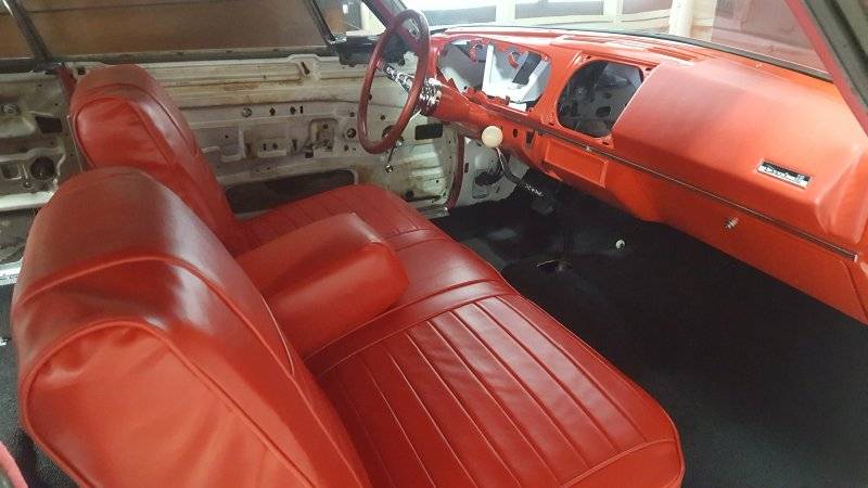

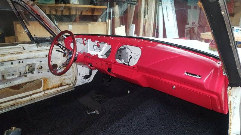

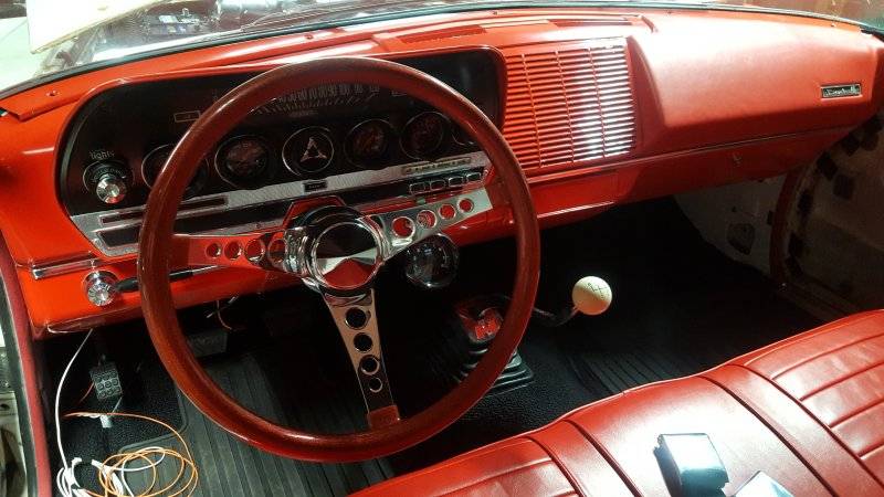

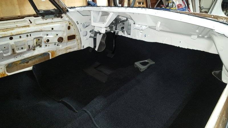

ACC carpet w/ 4 speed in a 62 Dart.
Got that extra underlayment, nice stuff, and plenty extra to cut off.
Fits pretty good around the shifter, not 100% but very good and certainly not an issue.
Left it in the sun for a few hours, you can use the seatbelts and seat brackets to keep it down as you stretch it out if needed.
