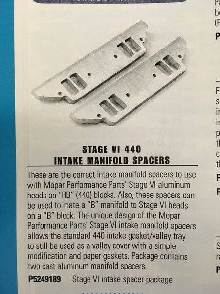

Twisting my brain thinking about mounting a Max Wedge Stage II intake to Stage 6 heads. Got a picture of how that works?
Seems like it should work on an RB with the appropriate spacers.
Or....... on a low deck without the spacers.
They would need to opened up to match the port openings on the heads.
They could also be made out of a piece of the appropriate thickness plate.
I’m pretty sure Jim knew this....... I posted it as “general information”.
Yes I've had several Stage 6 heads here with the spacers. The cross ram Max Wedge intakes I haven't handled since the 1960's. I thought the Max Wedge intake seals against the front and rear block rails? With the spacers and the Max Wedge intake do you build additional spacers to go under the intake to the block walls?
Yes, you would need end rail spacers as well.
They’re also used when running the stock style x-ram with Indy heads(if you’re not using the Indy valley plate).
Same would be true for TF270’s.
