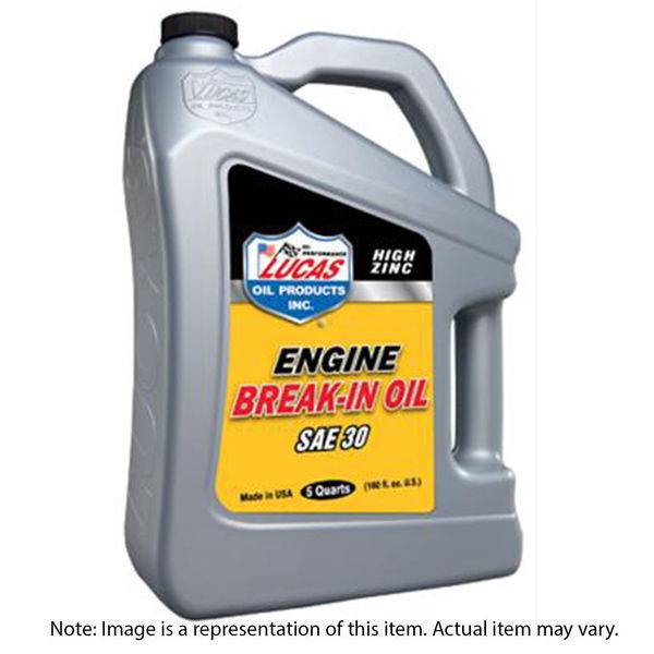

when new cam arrives will need to run-in 340 , so what is the best way to this.
these will be using
to break it in, but need to know what revs at how long etc.

I'll agree exactly with that above. Maybe 2100-2200 as a minimum. Definitely alter the RPM's a bit. The lifters MUST spin in their bores. Make sure you have known good gauges installed. The break-in oil is an excellent idea.
