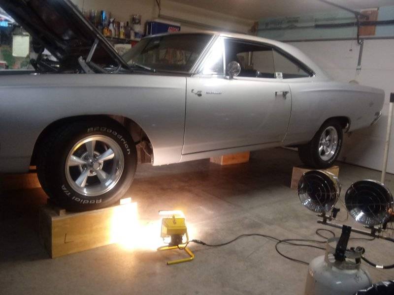

I put the car on 10" boxes I made I place a bottle jack under the flywheel with wood cushion snug and removing everything gear oil first last floor jack with a cupped lift point take a little pressure off roll jack back and lower as needed right out from under car when going back in lower bottle jack a bit and place trans counter clock wise to about 10:30 slide into place I do it myself at 67
