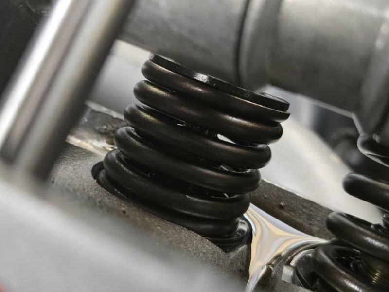

So the springs I bought wouldn't work. They were Elgin RV-869S springs. I did see that mine had inner springs and a damper, so I pulled the inner spring. At max lift on #1 exhaust (.588") there is no spring stack. Going with it.

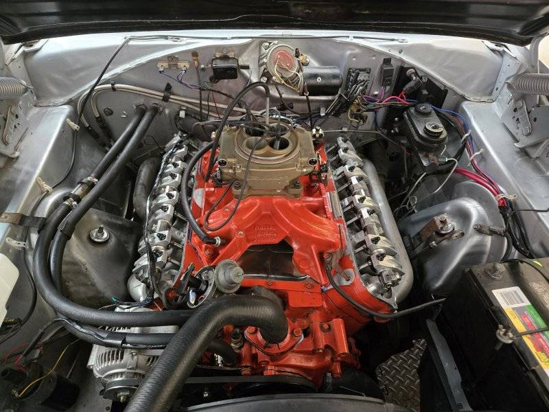

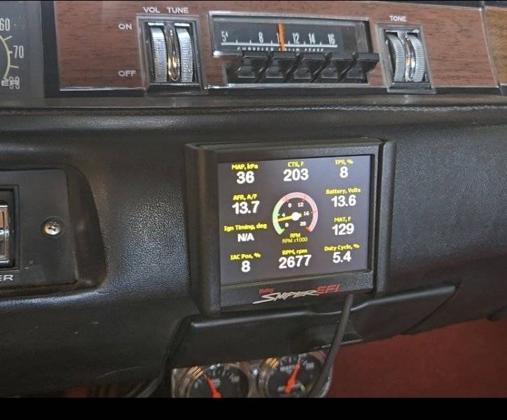

All back together. Used intake gaskets under the pan gasket and sealed everything using Hylomar. Oil and new filter. Have water in the radiator for now. Set my timing right on my old mark and it fired right up. Revved between 2k and 3k for 25 minutes, got a little hot so I shut it down. No leaks. Pulled valve covers off and everything looks good. Took it out for a spin and it sounds good.
At what point do I need to put the inner springs back in?
I would put your inner springs back in now since you did the cam break-in. Change oil filter, and add more break in oil to bring level back to full. Cut open old filter and have a look.
