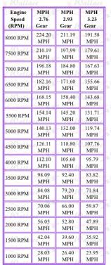

I don't know, if you love cruising at 75mph, to me it seems any gain in low end will be offset by a loss in highway cruising fun. Look at the chart below (using 26" tires as a guess), if you go from 2.76's to 3.23's you'll lose about 10mph in cruising speed. Is that worth it?
You'll easily spend $500-800 having a rear end built, so maybe it's worth it to spend that money on cam, intake, what have you, to build more power and keep your cruising rpm.
