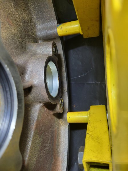

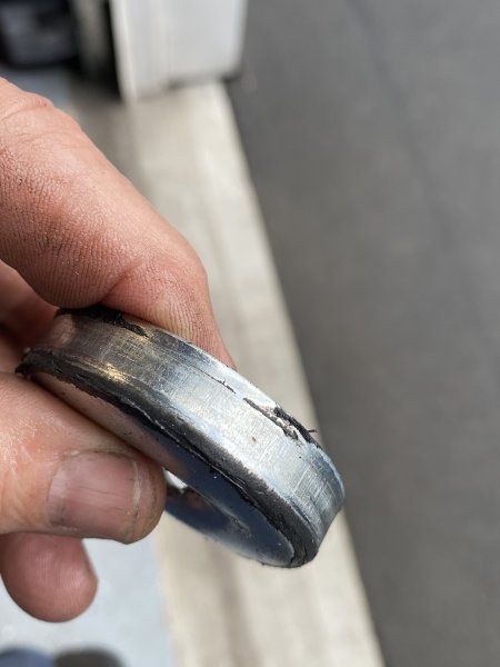

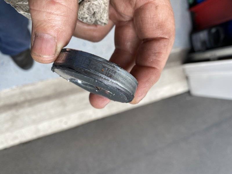

I had to take apart work that was recently finished because the camshaft core plug started to leak. Looks like the machine shop used silicone . They also just made the plug flush with the machined surface , pretty sure by leaving it like that you miss installing the widest part of the plug.
Anyway what is the preferred sealant on a core plug going into oil? I’ve used high tack and also permatex aviation sealant. Are there better sealants for this plug?
Dan

As a follow up I called Permatex and spoke to their sealant tech guy. He said definitely use the old school hardening Permatex #1 paste in the tube.

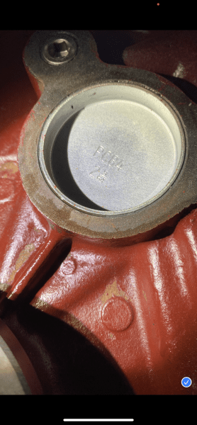

Another follow up, I took a look at a mill I'm building, the machine shop boys put it in flush. Which is what I would do, the step is in too far. You gain nothing going further in

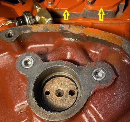

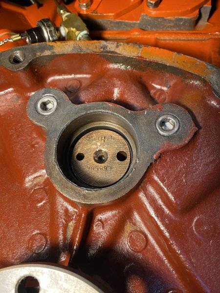

Small block?
...old school hardening Permatex #1...
Definitely something 'hard-setting' there - may see 100psi (or more?) oil pressure there. Not the 16-or-so psi of a water jacket. Just my 2¢
*Edit to acknowledge @Geoff 2 's comment below without needlessly bumping the whole thread.
Sorry, not seeing much detail on my phone.
Hemi manifold heat tube block-off plates. I noticed them on the 2nd look after you posed the question. I'm always on a PC - never on my phone... I forget that the rest of the modern world is the other way around! LOLz (I'm a dinosaur)
No, there is NOT 100 psi there. Very little pressure actually, just crankcase blowby pressure. See the 2 holes in the back of the cam brg? That allows the oil to flow back into the pan so there is no pressure build up.
