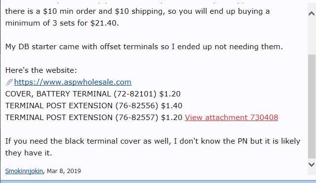

I've been running a NIPPONDENSO mini for years... no issues performance/starting wise.
This was posted by another member. Look under starter parts then Denso or search p/n's.
