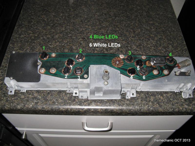

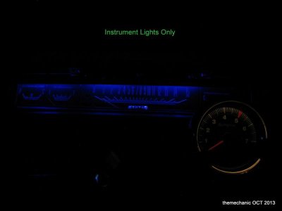

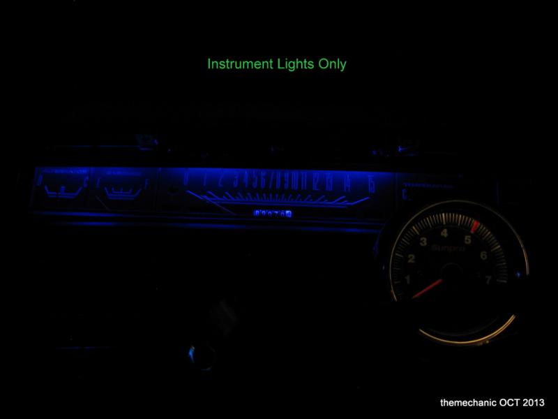

There are 4 back lights near the top on the standard dash cluster behind the guages. I used the multi-directional bulbs for the backlights (blue) and the forward facing white lights for the idiot lights and turn signals.
They were cheap and work well.

Jtech 5x 194 168 2825 T10 5-SMD Blue LED Car Lights Bulb (Item No. P7-HZBL-X61K)
These will not fit under the stock blue domes.
Jtech 5 x T10 8-SMD White High Power LED Car Lights Bulb W5W, 147, 152, 158, 159, 161, 168, 184, 192, 193, 194 2825
(Item No. L3-A0YN-1PKO)
