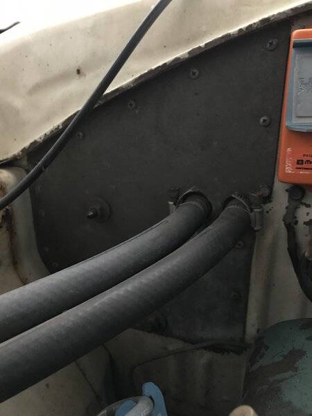

Body plugs , block off plate bolted through the firewall, of your pipes still stick through add some mastic putty to them.

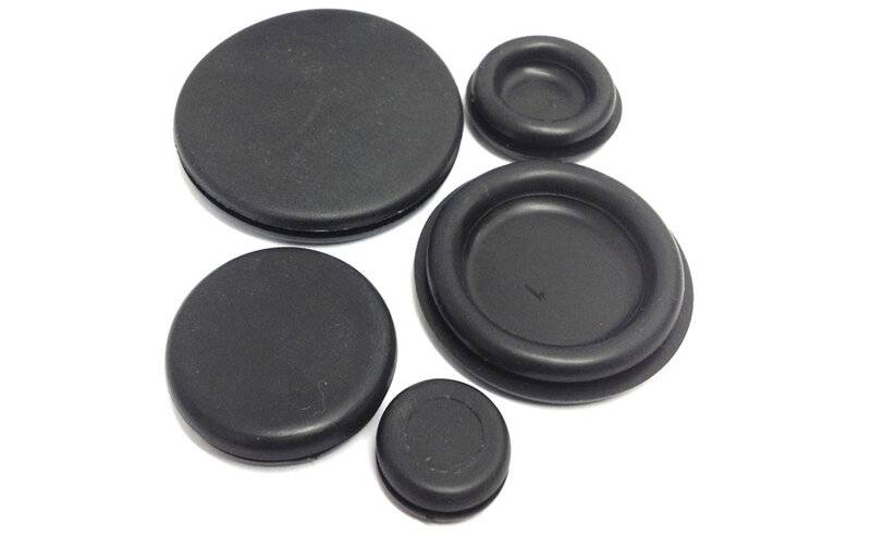

I used rubber blind grommets to fill the heater hose holes when I removed my heater box. They come in different sizes, cheap, quick and easy to install & remove. Very similar to body plugs but I could get them from the local foam and rubber place.

Make a pattern from paper, cut it out from at least 16ga metal using a jigsaw with a metal cutting blade, seal and screw in place. Been in place over 30 years, 4 engines, countless pressure washes and no leaks. Sorry it ain't pretty, function over form, but with a little paint it could look good till you restore.
^^^^^^^This! Or, buy some light gauge aluminum sheet at Home Depot or Lowes and cut with a good pair of sheet metal shears. A little RTV and a few self tapping screws and you're set...

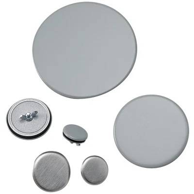

Home Depot , Lowes have press in steel plugs in various sizes. McMaster Carr has them all the way up to 2" diameter.
