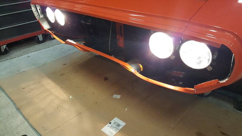

Installed Crackedback's kit on my '68 Charger. The kit and instructions were spot-on. Excellent upgrade!
Another option is the Hella H4 conversion assembly.
You can use any H4 style bulb.
I put them in my Charger and unplugged the two other high beams.
They are a plastic lens however.
Outside bulb

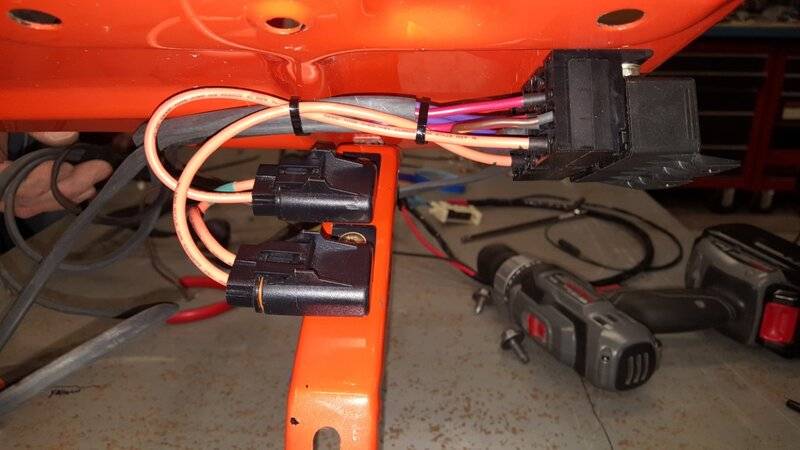

I used crackbacked harness for mine too. Attached is head lights on just battery power and not running. I hid the relays under my battery tray. Good quality and member

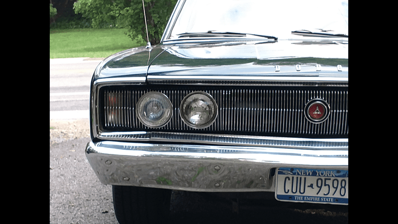

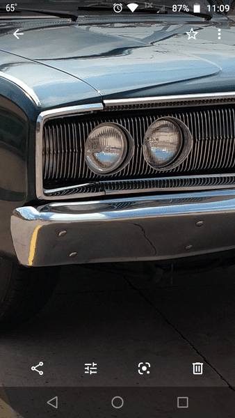

I'll take another picture tomorrow.
The difference in look is more noticeable from a straight on shot.
