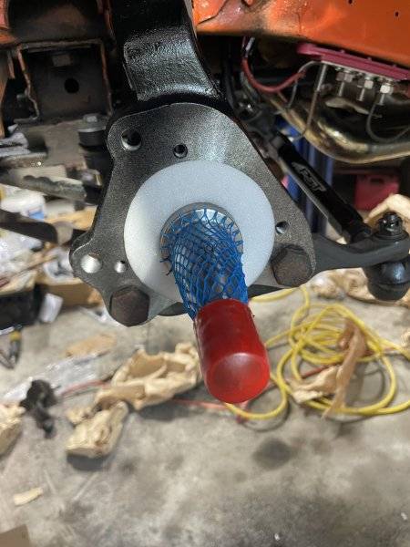

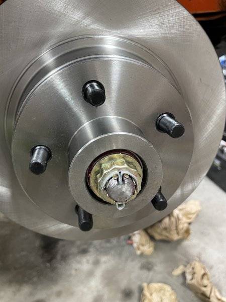

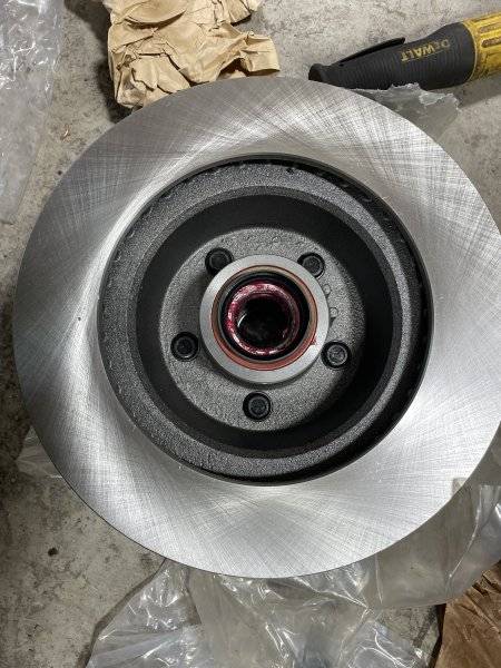

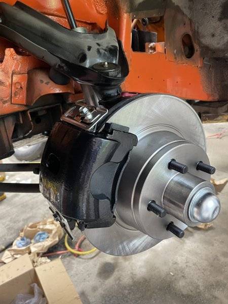

Ok I took the advice of Cass and purchased their brake kit with the new disc/ drum proportioning valve. I got the kit installed Friday, I plumbed new lines yesterday. I stripped the old ones when trying to get them out. Today I will bench bleed the master cylinder, reinstall it and test it today or at the latest tomorrow morning. I will let you know how things go.
