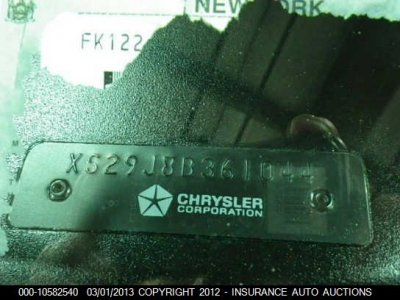

here is the sandy charger vin number pic

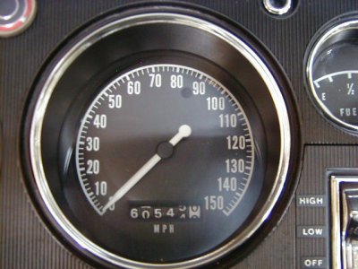

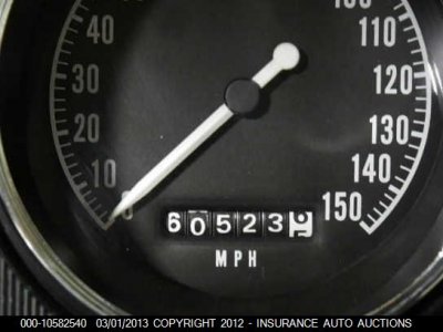

here are the ebay speedo and the sandy speedoebay charger.JPGsandy speedo.jpg
