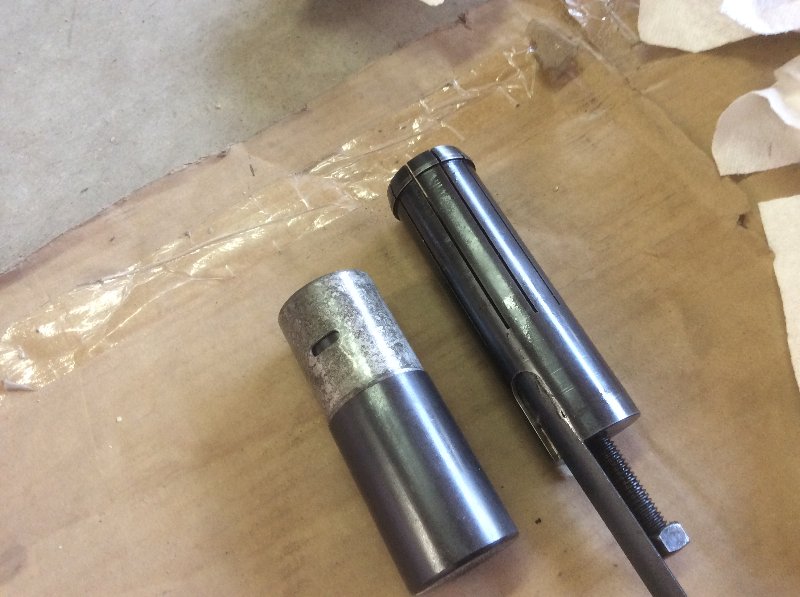

Tailshaft bushing possibly. If you grab front yoke and it moves .010, had .013 on mine rattled at 65 mph.Puller and installation tool.
Tailshaft bushing possibly. If you grab front yoke and it moves .010, had .013 on mine rattled at 65 mph.Puller and installation tool. View attachment 1985820
Replaced the bushing already and no improvement. However, it does feel like there is some play when moving the slip yoke.
