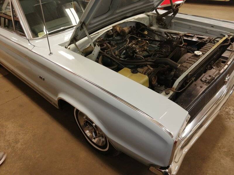

Can anyone tell me the exact length of a big block cam? I am trying to figure out if I can swap the cam in my Charger in the car without having to remove the A/C condenser or grille. I have to change the intake this winter anyway, so I will be half way there.
The cam is just a little under 23".....but you'll need a bit of wiggle room
Thanks guys, I will get out the tape measure tonight. With factory air there is a lot of stuff in the way.
Never tried to stick in a cam with the radiator in place but some cars have the room I'm told....but it's a good idea to place a piece of cardboard against the radiator to protect it.
Radiator definitely would have to come out. The issue is with the A/C condenser. Didn't want to have to open the system after I just got it recharged and working. If there is enough room the cardboard on the condenser would be a good idea.

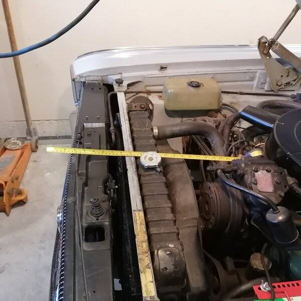

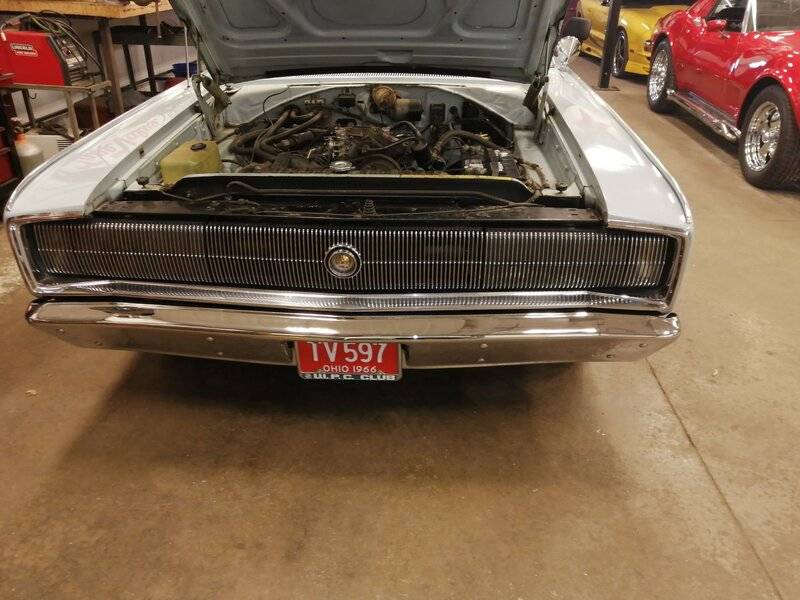

Looks like no cam change in the near future. The tape is set at 23 inches, and extends a couple of inches beyond the grille.

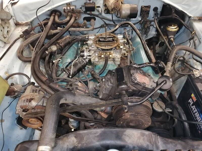

You can change a cam in an early Charger without removing grille. The condenser though,, if the hoses go over the rad support could it not be lifted/moved?
Maybe??? There is a flex hose on the drivers side and a short flex hose on the passenger side between the receiver/dryer and the firewall.
If you go ahead with the cam swap, take a bunch of photos of all the accessory bracket configuration. It can be a real puzzle to put back together correctly.
I have to do an intake swap, and there are enough brackets and hoses that I will need to take a bunch of pictures just to do that.
