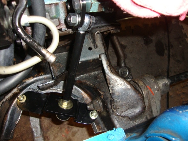

Big Block driver side motor mount strap
Use the Schumacher set up! You won't be disappointed.
I really like the looks of that Schumacher torque strap. When I nail my 440, it twists so bad that it throws my pistol grip 4-speed handle way over to the right and makes it hard to shift. I have a 70 Charger with power steering. Do you guys know if I would have to remove the power steering pump to install it or drill any holes?
It bolts to the engine block and the k frame. Go to their web site and check it out.

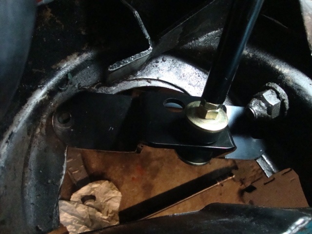

no and yes. you need to take the power steering BOX out and drill a couple of holes in the half-moon part of the driver's side k-member

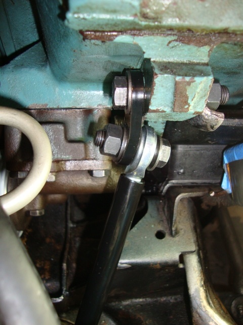

EXACTLY why I installed the Schumacher "torque strap." my old {probably} chinesium mounts dented my hood. replaced the old mounts with new {probably chinesium} mounts and added the strap.
Edit: I just noticed on Schumachers' website that the "torque strap" now comes with a heim joint at the motor; mine is a solid mount. WTF.
I just emailed Schumacher to see if they would be willing to sell me just the heim joint...
Ill keep y'all posted.

When I decided to build a shaker scoop for my Charger and didn't want a big gaping gap around the scoop to allow for motor movement I built one of these (torque strap). Using factory rubber mounts with a strap means no unnecessary vibrations and no broken mounts or at least yet, to me this is the best alternative. I source a lot of parts like the heim joints threw McMaster Carr, it's an Industrial supplier that I use at work........ a lot of money can be saved threw companies like this.

I'm with Mar on the Shumacher torque strap. I used to break motor mounts all the time with my mostly stock 440. Now,that it's stroked and has almost 200 more hp I went with stock motor mounts and added the torque strap. It's cheap insurance, holds the engine down and keeps her from twisting. Didn't have to drill any holes. Don't know about the PS pump cause I have manual steering. Well worth the $$ and no vibration.
I bought my motor mounts from Summit, they were complete junk! The stud was to long causing it to hit the block (had to trim them off) and the nuts were welded on crooked resulting in me grinding the welds off and re-welding them. The torque strap can be installed without removing anything, I drilled mine from the bottom just have a sharp bit so it goes quick.

If you have a 70' and up k frame, the holes are already there. They use the sway bar mounting holes. If you have a 69' and down, you gotta drill holes.
