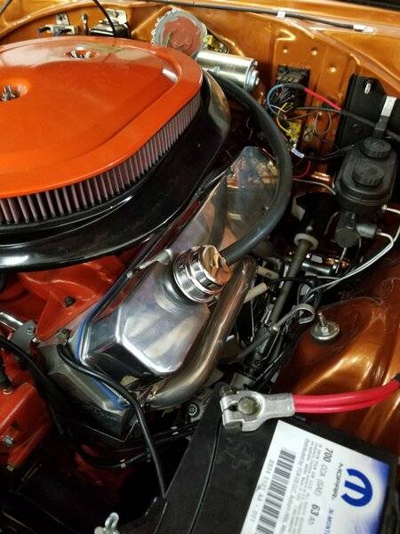

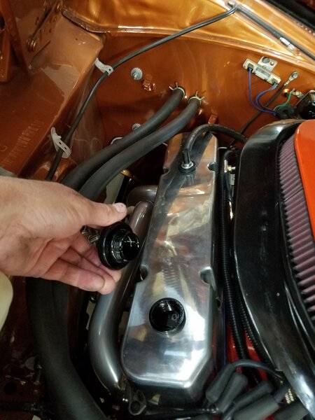

I must have got a better set than you. My holes all lined up, mine are on Trick Flow 240's however. Didn't have any issues with grommets either. I also added this fill cap which works great.
View attachment 1117223 View attachment 1117224
Im sure the trick flows make the difference. Im betting the trick flows have the valve cover hold down bolts 90° to the valve cover surface. Factory iron mopar aren't.
