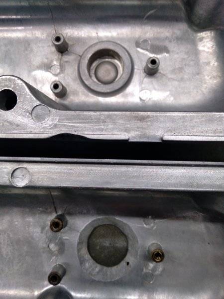

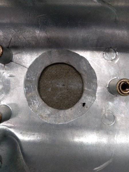

And then there's this.
It's been years, and my pics are gone now with site updates, but the fact remains that the dog ears left the factory with metal defects no one was inclined to do much about, leaving nearly every victim believing they simply over-tightened them.
These days the MPs are still very popular with enthusiasts (I'm working up a small block set right now for a guy in Australia). If you can find an intact set under $400 consider yourself lucky.
My guy just got half his money back last night as timing would have it. He wasn't so lucky ...

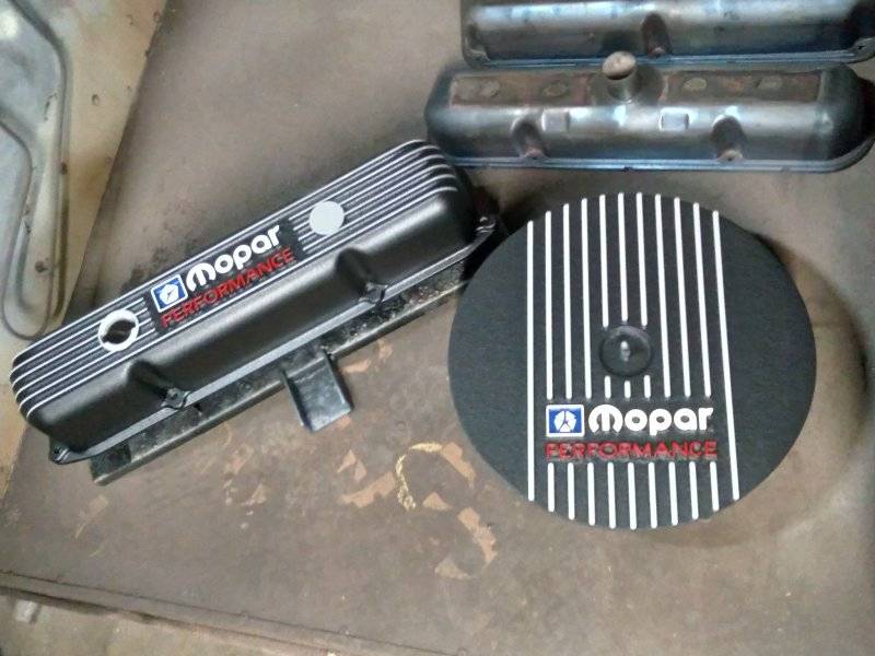

Hit me up if I can help with yours when you find some! (I have one set in my stash with one knockout opened if you're inclined to get them dolled up.)

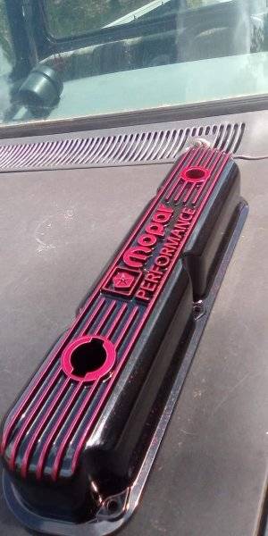

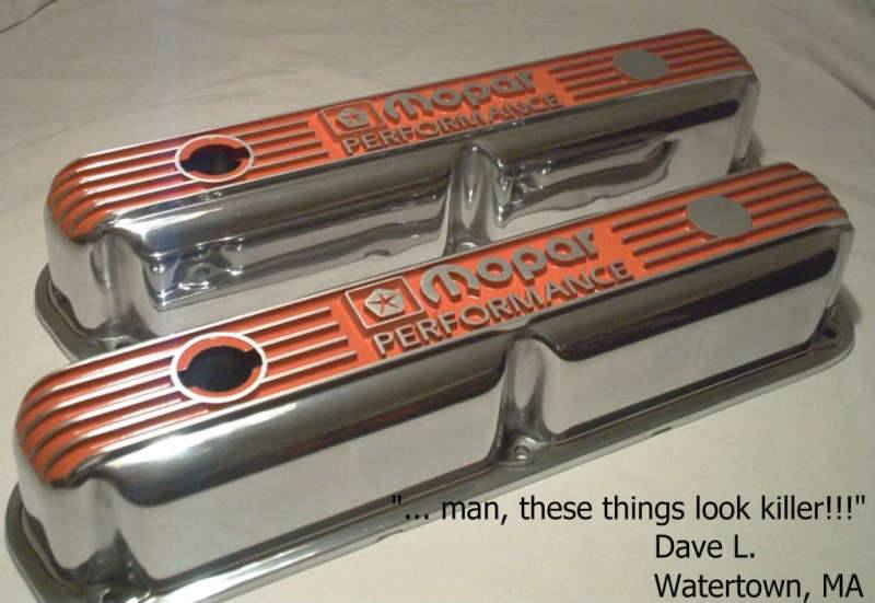

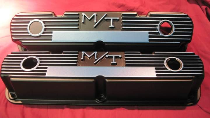

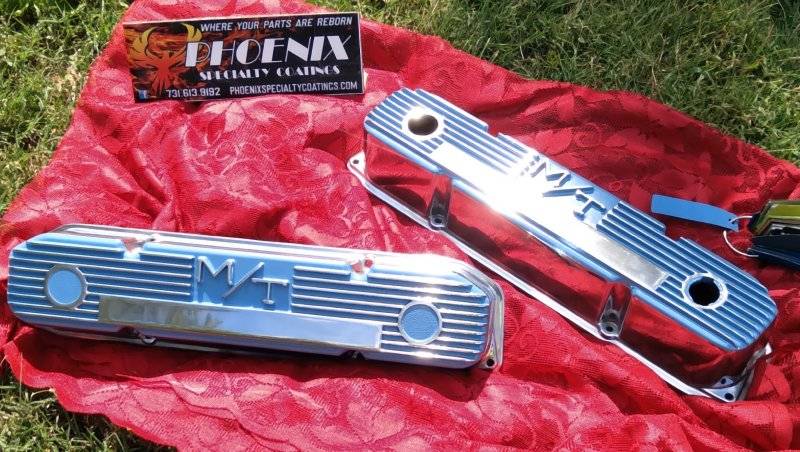

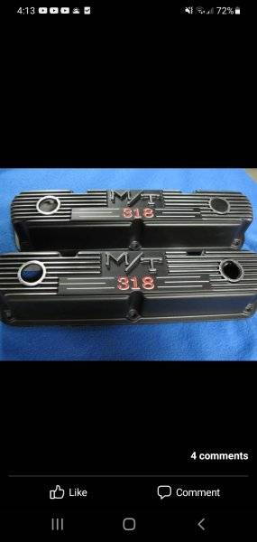

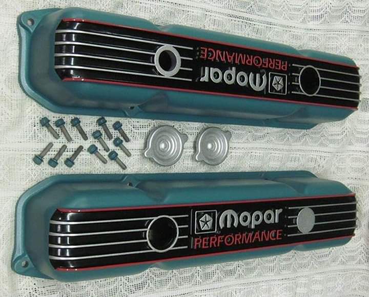

Here's a few ideas on aftermarket covers to spark your imagination.
View attachment 1385937View attachment 1385938View attachment 1385939View attachment 1385940View attachment 1385941View attachment 1385942View attachment 1385943View attachment 1385944

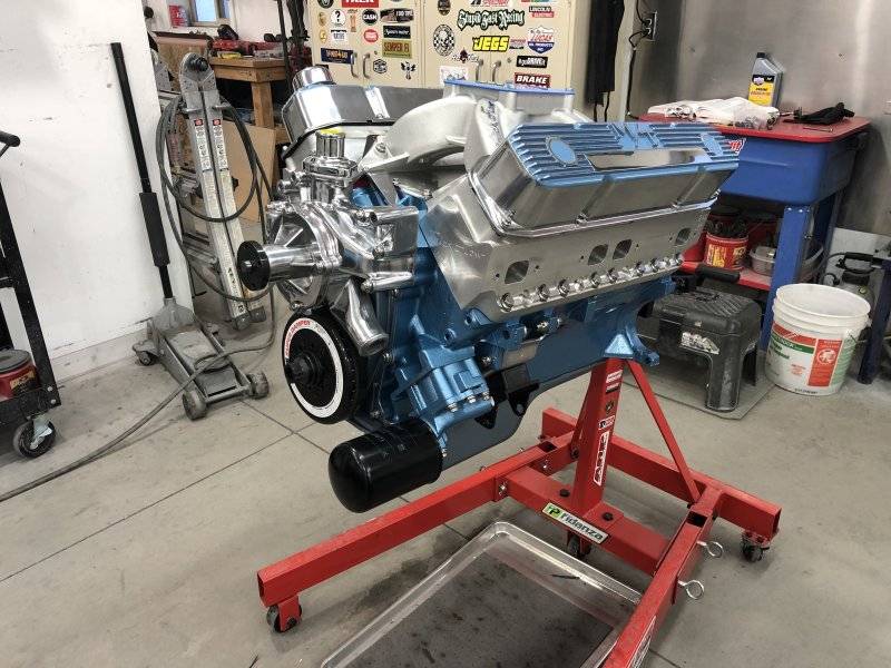

Geeze Leanna, that last pic of those blue MTs look incredible. I wonder what kind of bad assed 500 inch stroker is sporting those.

He's a great dude with cool ideas and a beautiful ride. Wish I could remember his name though ....... lol

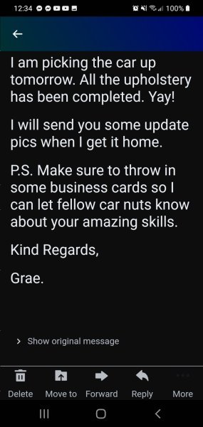

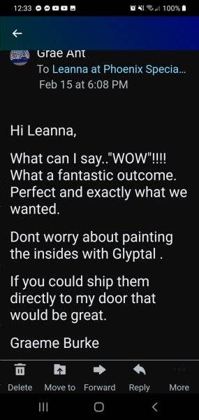

As timing would have it, the butchered covers in my last post up there for the guy in Australia just got done Wednesday night after a lot of reconstruction work.
