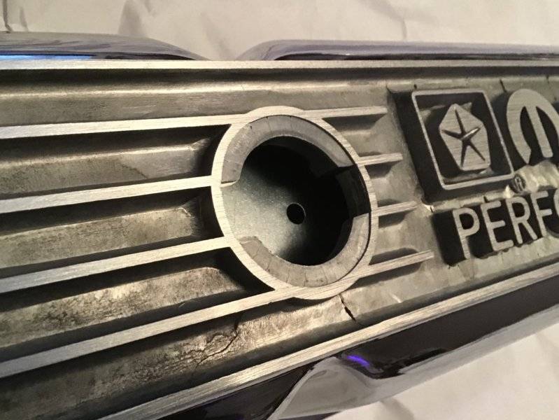

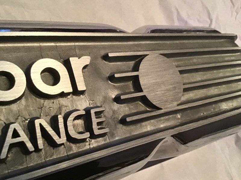

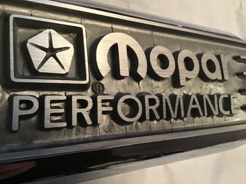

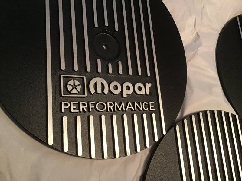

The air cleaner bases are decent but the lids have a bunch of casting flaws too.
There's a big "box" of excess metal that surrounds the MP logo, tall on some and uneven on others.
Though the lettering overall is cleaner and sharper, chipped fins are normal.

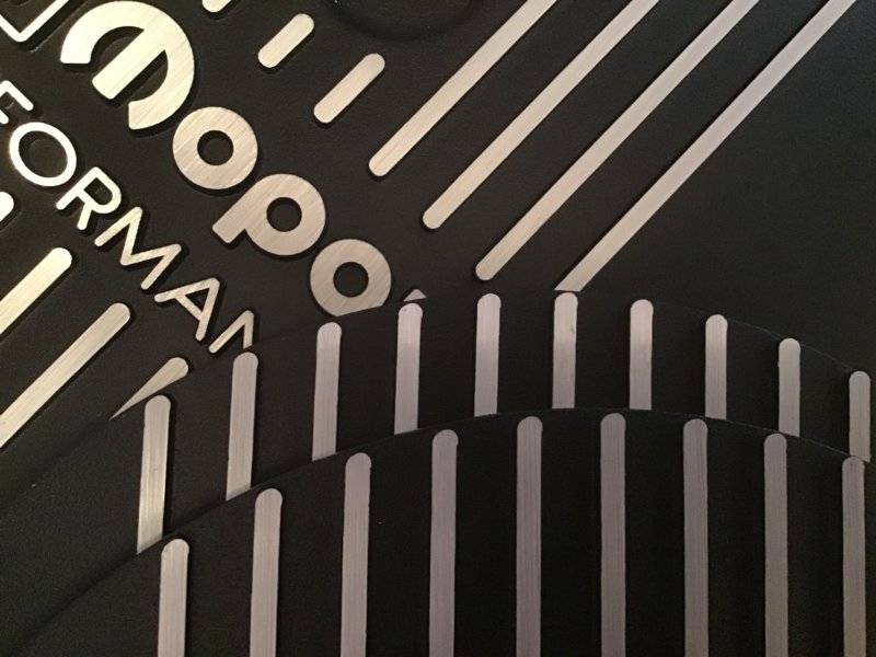

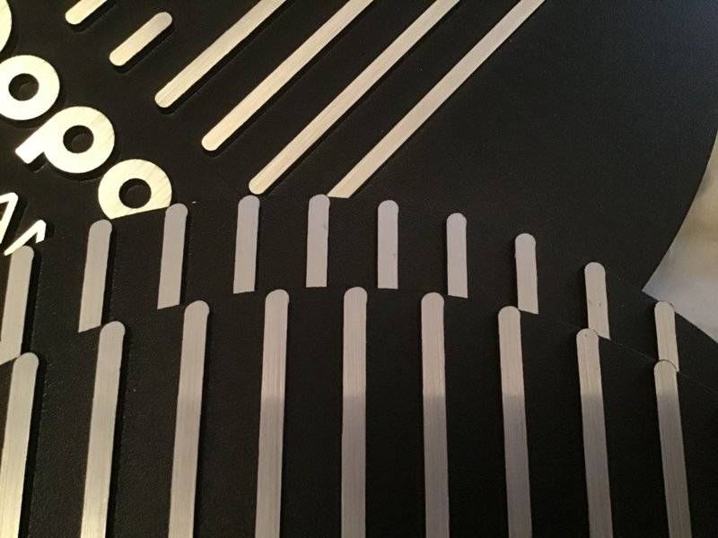

The most noticeable defect to me -- being a woman :wetting:-- is that the ends of the fins are not uniform in the least and look like ....... well, there's no delicate or ladylike way to say it ...... little dicks.
I always have to round them off (they lean the other way past the center) with my riffler files.

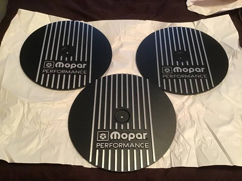

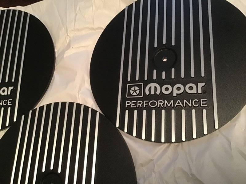

3 originals here and you are Absolutely correct. :drinks:
And a few up close photos of the covers.

They are the "as-cast" and not polished. It would take quite a lot of sanding then polishing to get those to look like something. I kinds think that they may be the ones that MP thought would be too much work to bother polishing , i could be wrong .
I bought a new set of 'as cast' few years ago. Mine were not a good casting & would'nt shine up to a mirror finish like I wanted. So I painted them & shined up the top ribs the best I could.
