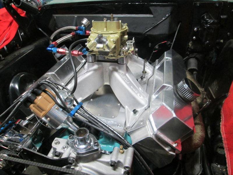

I am currently running the Trickflow valley cover with removable inspection cover (Summit). I used the "bat wing" intake gasket holders from ARE to seal everything up. I have had this engine running all summer and not a drip of oil from this setup. Think I paid around $150 or so for the valley cover and maybe $30 for the bat wings.
I did have .050" removed from each side of my Victor intake to make everything line up perfectly.

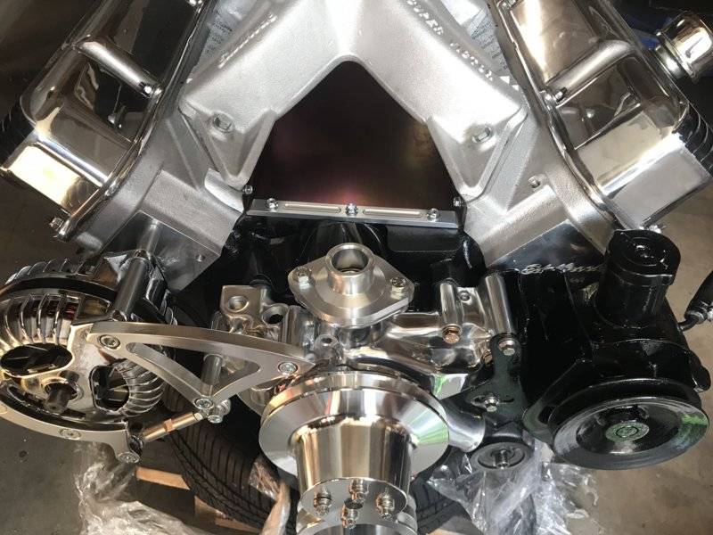

The bat wings provide a thin metal gasket at the intake runners but also provide a 90 degree surface that seals against the aftermarket valley covers.
Look in my picture where my intake meets the valley pan. There is that sealing surface that the bat wings provide that you won't have otherwise
