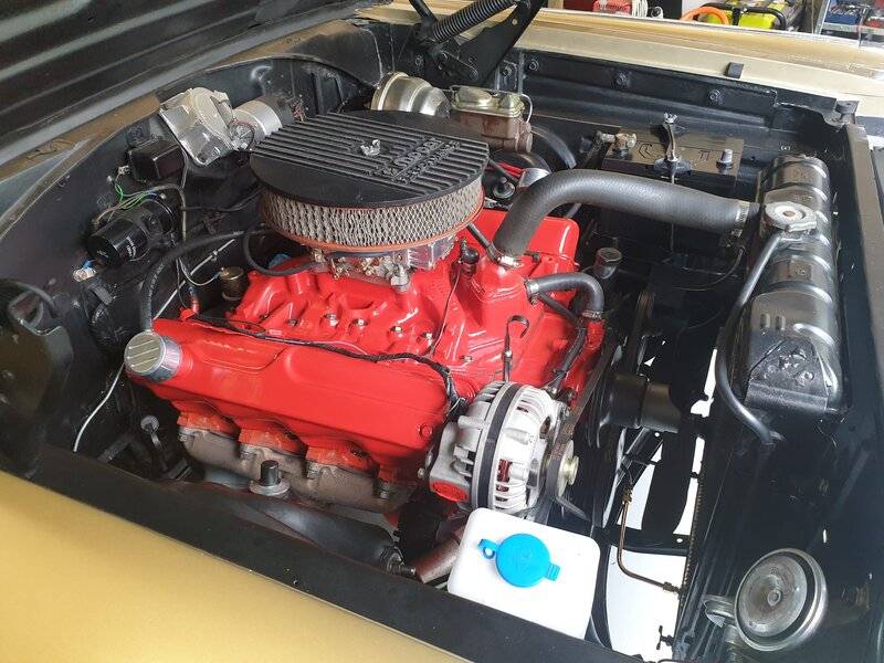

An RB or B series BBM
Compared to a Polisphere Small block/wideblock "Poly"
not much different dimensions or size under the hood
allegedly weights appr. 600+#'s
performance 101
BBM has the distributor up front easy to work on
any of the below has batter flowing heads
a base
