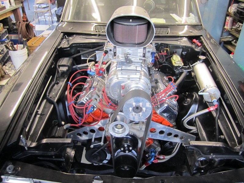

MOPAR housing & pump for me.I prefer the pentastar!
Show off, lol!!
