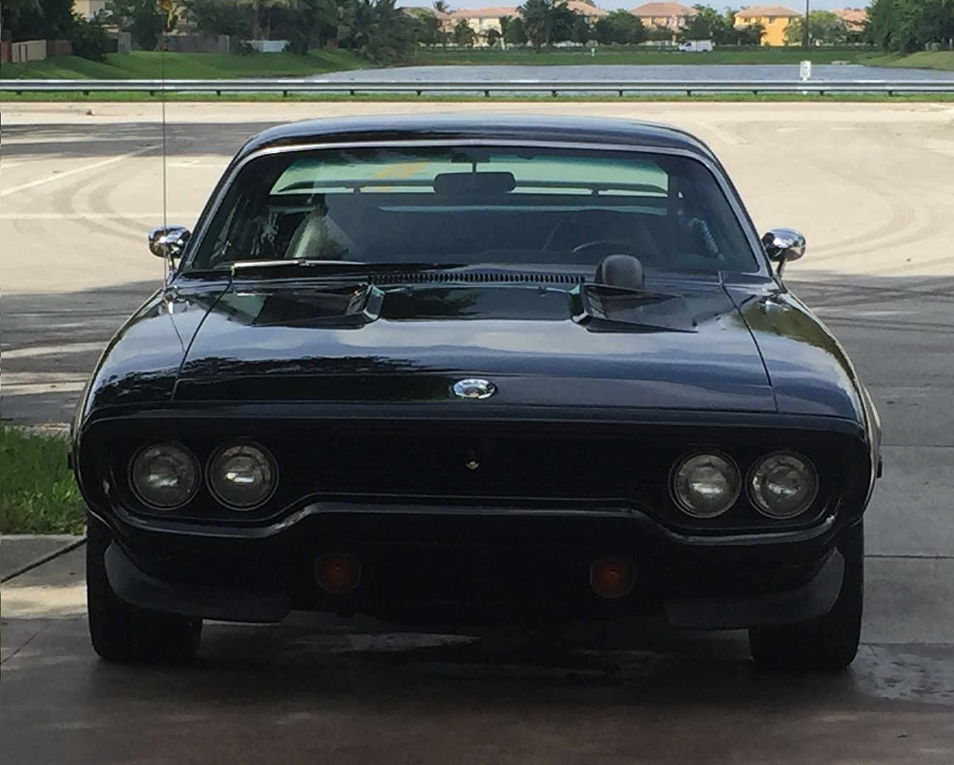

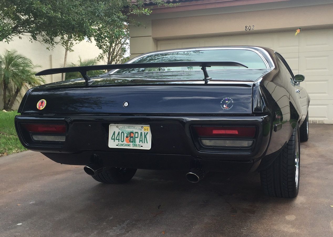

You sir have a sexy bird. But when you do the 451 you need to match that sexy ride with a sexy pair of TTI long tube headers. The sounds it will make. Stock exhaust just won't do it for you ever again.

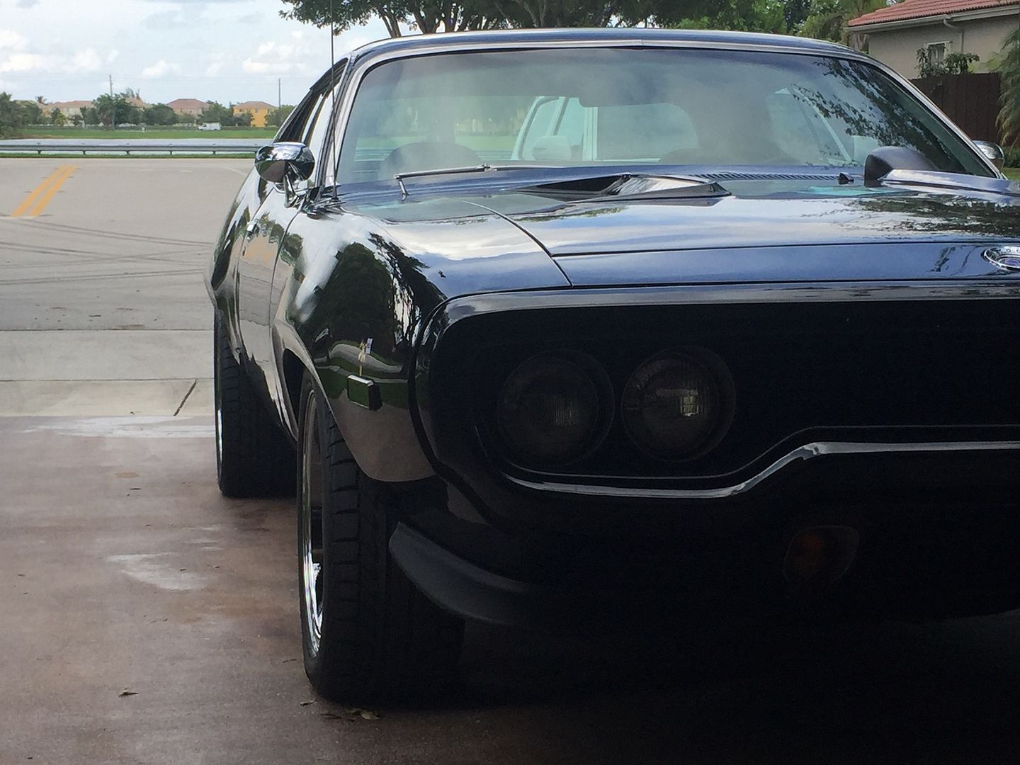

Damn,,those wheels look great on your car! Can you give sizing and brand of wheels?

Here are the specs:
Front 17x8 w 4.5"bs and 245-45 bfg2
Rear 18x9 w 5.0"bs and 275-40 bfg2
But....I added hubcentric spacer/adaptors front and rear to fill the fenders out a little more.
added 1.25" front and 1.00" rear. Essentially it made the rims 9.25" front and 10" rear, without having to spend an extra $600 for custom order rims. The adaptors were not easy to find, but they are an EXACT fit (critical with adaptors) and they were less than $100 total.

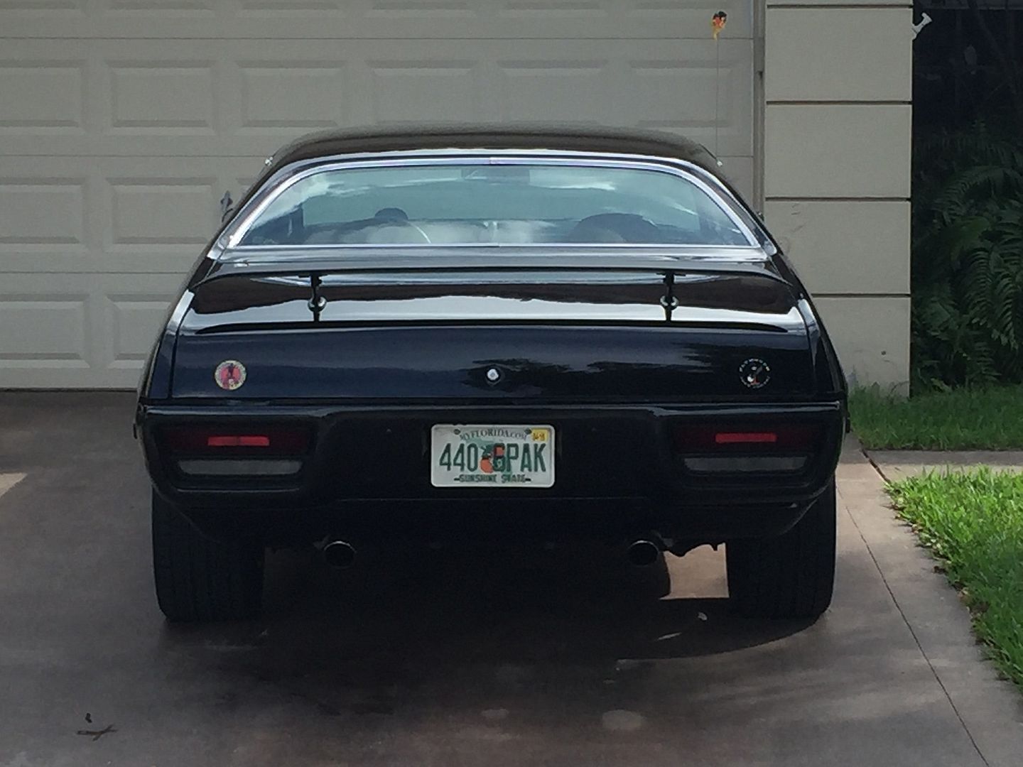

I like the stance:
