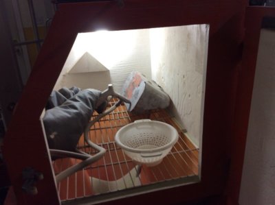

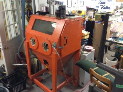

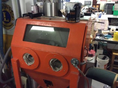

I had a hard time fitting it into a photo, but here it is.
More then twenty years old, used nearly every day.
I did it, you can do it. Two sheets of plywood, wire shelving, and a gate latch. The tempered glass was a shelf I found at the dump. Painted orange because that’s what I had for scrap paint.
