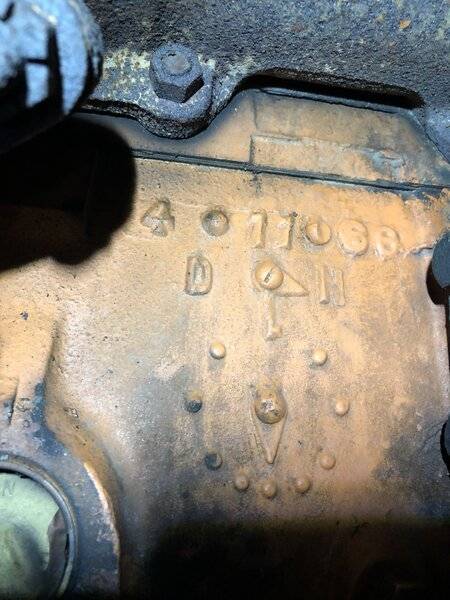

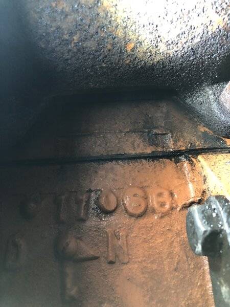

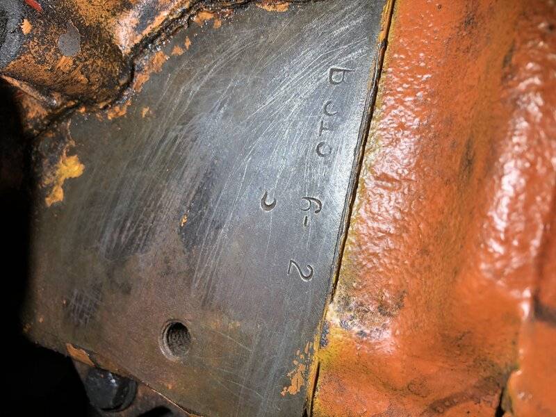

i found engine production date on right side of block 4.11.68 and the D >N and the clock points down to bottom dot
does anyone know wr i look for serial or other number

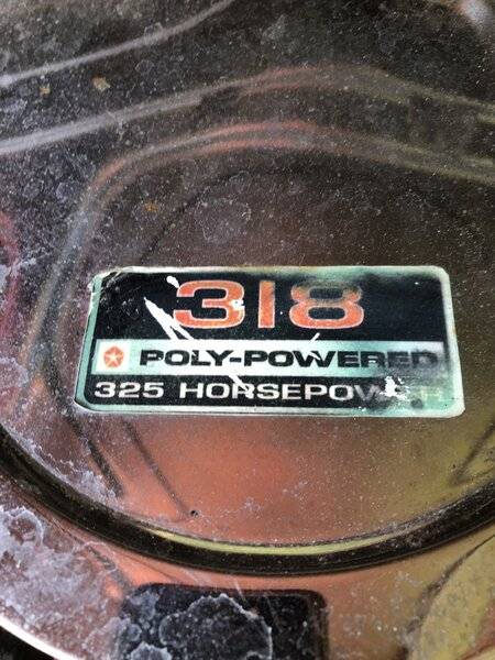

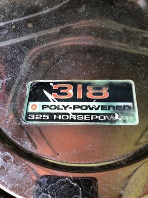

is there such a thing as a 318 / 325 hp it looks like a factory decal

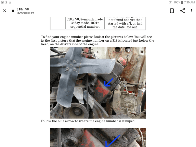

Your casting date would be 66, not 68. There will not be a VIN stamped into the block. There should be some numbers stamped on the driver side front of the engine below the cyl head, that would state the model year, cubic inches, and the assembly date of the engine. Your engine would have come from the factory with 230 hp.
Your casting date would be 66, not 68. There will not be a VIN stamped into the block. There should be some numbers stamped on the passenger side front of the engine below the cyl head, that would state the model year, cubic inches, and the assembly date of the engine. Your engine would have come from the factory with 230 hp.
i'm thinking that is not original engine and trans
You need to find the stamped numbers on the block, to determine if it could be original or not.
Sorry! The stamping is on the drivers side front, just below the head. I corrected the above post.

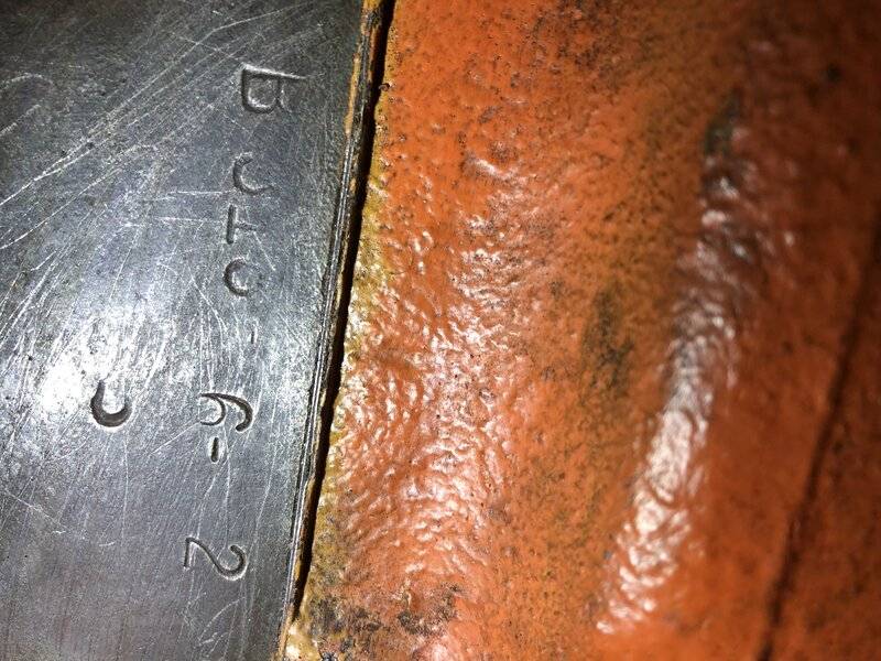

1966 318 with a June 2nd 1966 assembly date. If your car is a 1966 and the fifth digit in the VIN is an E, then you need to check the scheduled production date of your car. It will be the first three digits on the lower left of your fender tag, under the SO Number. It will also be part of the body numbers on the drivers side of the rad support. The SPD is not necessarily the actual production date, but it is all you can go by. If the SPD is later than June 2nd, then it could be the original engine.

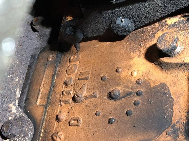

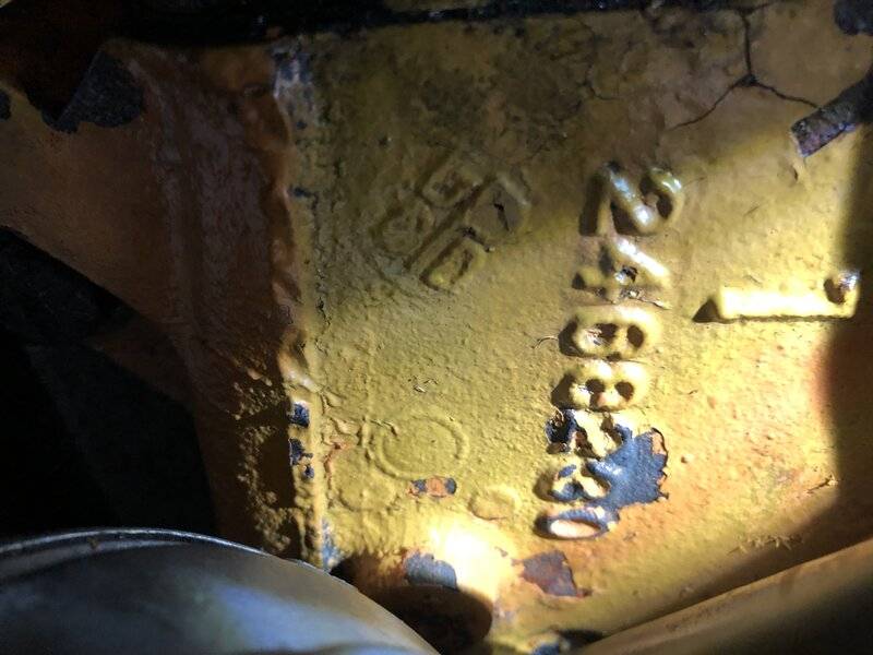

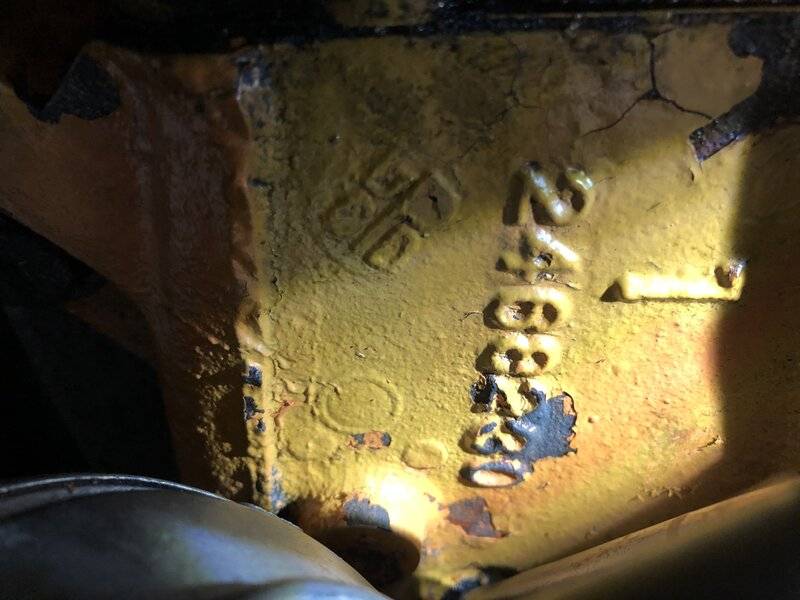

what is 2488230 on the R/F of the block
Scheduled production date of June 3 1966. The engine is June 2, which looks good for the engine to be original. 2468230 is a poly 318.
