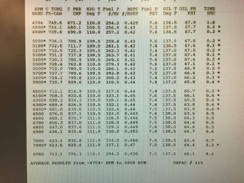

Take it from me, been there and don that. If I could do over I’d start with a good block.
Like others say. It can be done. For how long? My 400 based 511 seems to have to come apart every 50-60 passes. It’s been 10.12 @133 at a starting line weight of 4100.
Billet mains, lifter bushings and all the machine work to get it where it is now was not cheap. #7 has a score in it and I am waiting for the machine shop to tell me if it’s a boat anchor. It’s already close to max and not much left to work with.
Also remember the motor is only part of the whole package. Proper trans, converter, rear end and suspension need to also be in play to run the number.
Right now I am running a second slower with my back up 440.
I’m at the point where as much as I hate going slower, I want things to hold together.
If my 511 goes back together I will tone it down a touch and save it. If I want to go faster, I’ll find another 250 pounds or so to pull off the car.
Many tricks to reduce weight while keeping it street.
Here is the 511 Dyno sheet.

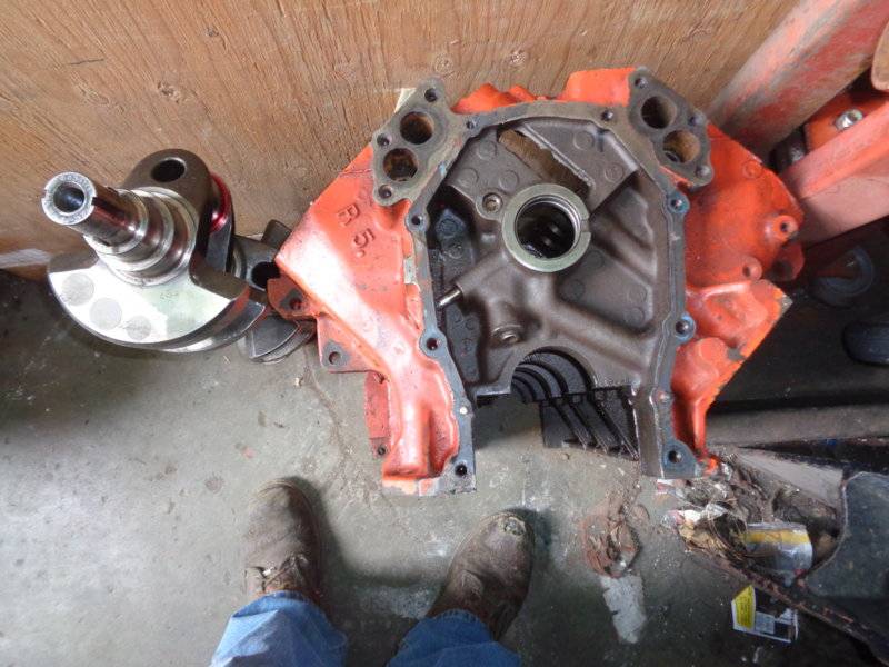

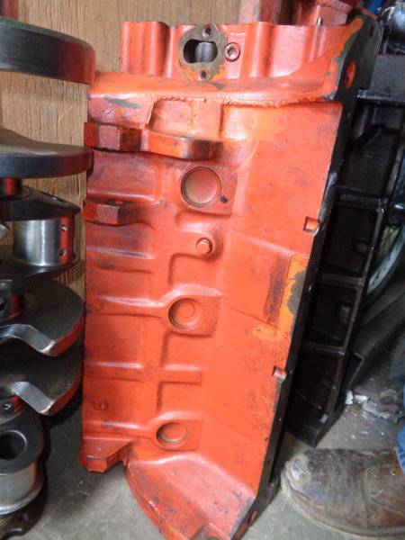

these block can be bored big , lots of factory webbing and thick cylinders .
