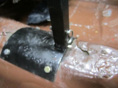

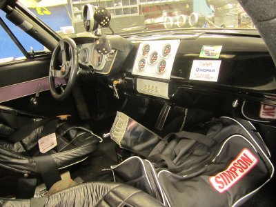

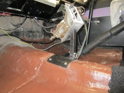

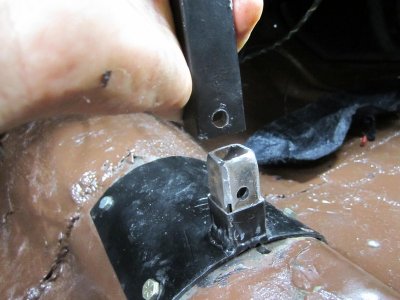

Stay true and use the push button shifter:blob1:
Absolutely, Hemi-its. I can't remember, did you mount your push buttons back in the dash or on the floor? I'll probably go back to the dash.
Score another point for the 727; very cool shifter mech!!!

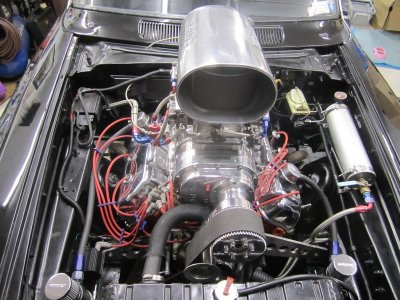

Blown and injected like this:
View attachment 219112View attachment 219113
Dodge legends.
Nope, More like Hemi-it is..
:angel3:I'm a righty
