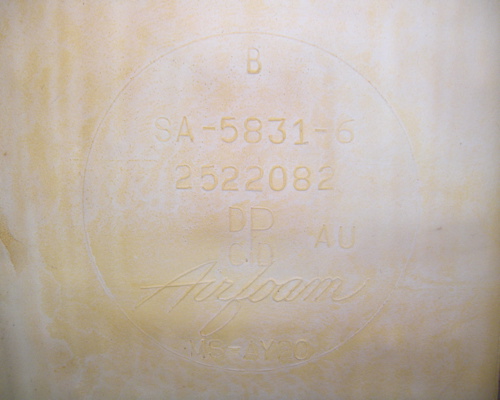

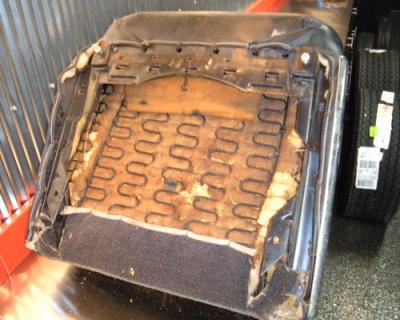

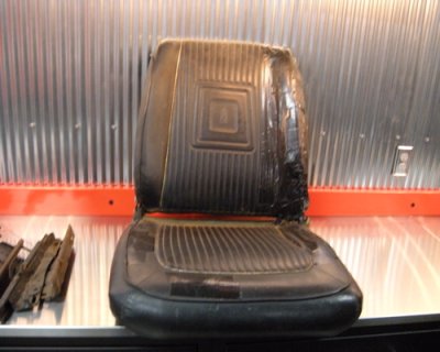

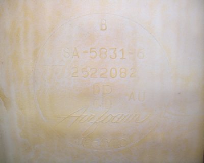

on the softer side. decided to reupholster the set of bucket seats i've had for about 4 years. tore them down to the frames this afternoon. I have the new foam and the covers are coming from Legendary in a month or so. some of you guys will know what these came out of, I was told a '65 something. don't remember.... doesn't really matter to me, just a different look. the passenger seat back foam was in descent shape. a bit of history there. 50 year old foam with the good old AMERICAN mfg. markings,,, sad really...

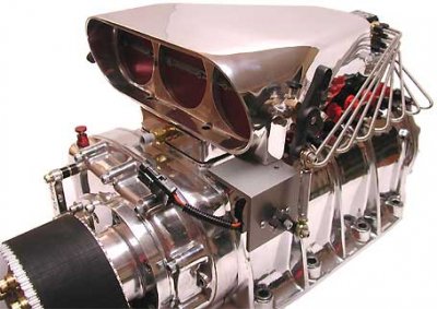

I was with uncle ray last week picking up my stuff he has a cool injection system hidden under the manifold there
Received the overview list and estimate from Ray Barton Racing yesterday. Fairly vague in this post, I'll get more detailed once he gets into it, but you get the gist.
Rebuild Hemi, Blower Upgrade with EFI, 800+ Horsepower

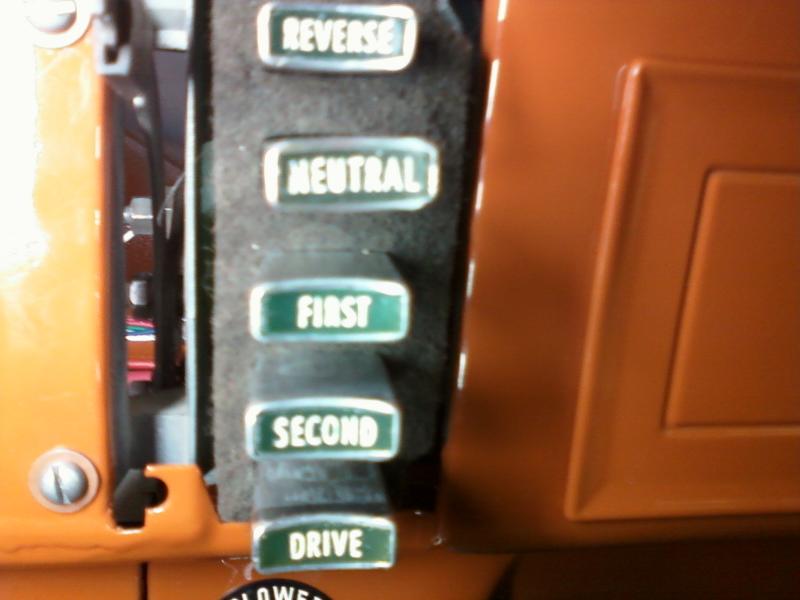

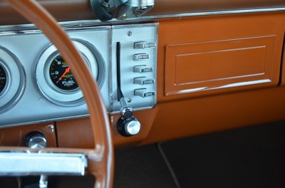

I run a pushbutton 727 with close to 875hp. As of now it even still has the factory low roller. Aftermarket drum, stock shafts. 200 passes in the low 9's. Buttons are moved to the right side for roll cage clearance.
Doug

I like the idea of moving to the right side DVW. I'll keep that in mind during tear down.

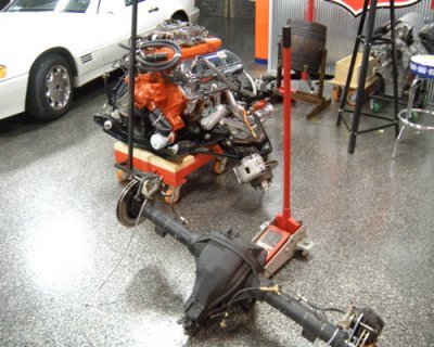

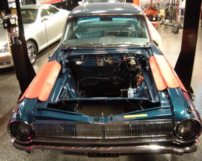

Woke up this morning and decided to do some disassembly, a friend stopped by at about 9:30 and by 11:30 had the bottom dropped out. That included a coffee break around 10:30. So easy to work on these cars. still don't have an ETA and the engine from Barton, that's OK. no hurry...

now I'm feeling lazy, thanks...LOL
Nice work! What did you do the rest of the day? :beerchug:
