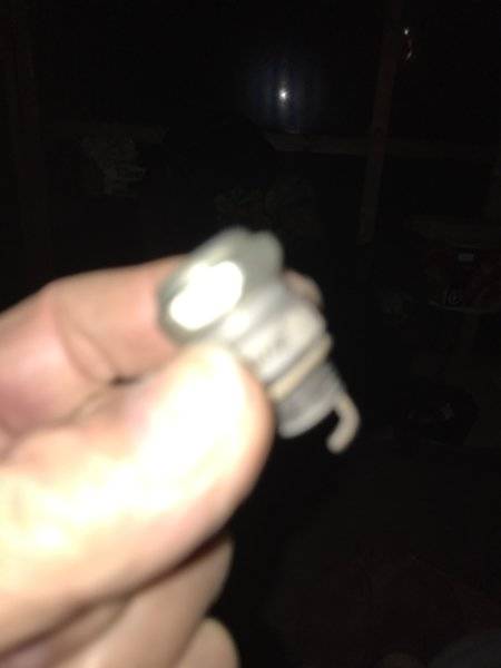

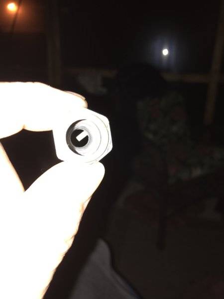

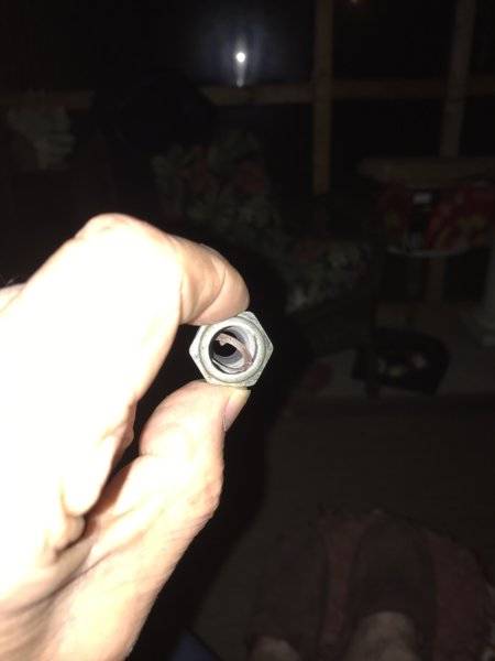

Anyone ever seen a champion Rj12 blow out like this ? No damage to threads and base still in head all pocelion gone and the plug boot hanging ! What you guys think??
Plug base still intact in head but everything else gone yes and no problem in cylinder I hope

The plug in the OP's picture is about the only thing I haven't seen a Champion plug do. Now I have.
Did it lose everything outward
I would think the strap on the plug shouldn't have allowed anything to enter the cylinder. Maybe a small piece of porcelain at the most. Look around in the engine compartment and on the frame for the porcelain.
I had one do that years ago because of detonation. That was the only incident I'd seen before or after.
Had this happen last spring on my boat with ot bbc. The plug wire was still connected to the center of the plug( Champion) laying on the floor of the engine bay with the plug wire end on fire , threaded metal section of plug still threaded in the block .Fire is NOT good on a boat in the middle of the bay. Plugs were fresh , first run of the spring.
