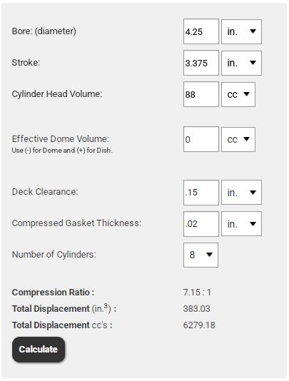

You don't see that I'm using an endoscope to see how far in the hole my pistons are, and using a .060" wire to estimate the measurement? I thought I explained that. Using 2.5D is .150". Do you think 88CC is a poor estimate for a 906 combustion chamber? This is what that comes out to.

Regardless of the actual deck clearance you obviously have to much for a performance camshaft. I don’t know your bank account or power goals but if you can swing some pistons with CH that puts you near zero deck and a hone job you would have a much better foundation to build on.
That’s got to be the lowest CH 383 piston ever made.
A Silvolite 1271 replacement piston has a CH of 1.848, which would theoretically put them at .0865” down the hole……..which works out to 7.8-7.9cr with a .020” gasket and 88cc heads.
And those aren’t any type of performance parts.
Pistons .150” down the hole on a 383 is not a foundation I’d be building upon.
For reference, the Silvolite replacement 400 piston would be .122” down the hole.

The guy I got the car from was a Chevy guy and knew nothing other than Chargers are cool. It was sitting for 18 years before that, and it's a '70 motor in a '69 Charger. Have no idea other than what I can see. That is a .060" wire. Looks easily more than twice it's thickness from piston to head gasket, doesn't it?
It certainly looks like it’s significantly more than .086” based on that wire being .060”.

And I do believe in your borescope photos..... but I'd probably pull a head anyway, just to make sure of the deck height. (If the piston is not at exact top dead center, it'll look way down the hole)
Actual measurements are MUCH more valuable than guesswork.

If the pistons are down as far as they appear to be, there isn’t really a cheap & easy solution for that.
Other than perhaps finding a used shortblock for a reasonable price that’s not whipped or seized to the point where it would be okay with a quick re-ring job

A compression test would probably shed a little light on just how low the cr is.
7:1 and any cam that had any kind of lump to it would likely pump under 125psi.
I remember trying to “tune up” a rebuilt 360(that as it turned out had about 7.5cr) with an Ede Torker plus cam in it.
All holes real close to 110psi.
Yes, it was a dud.
