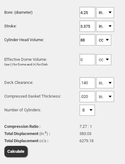

"The pistons are .155" in the hole, which means, that's 7.5:1 so after I put the heads on with the composition gasket instead of the factory steel shim, 7.4, so what's a tenth of a point between friends right?

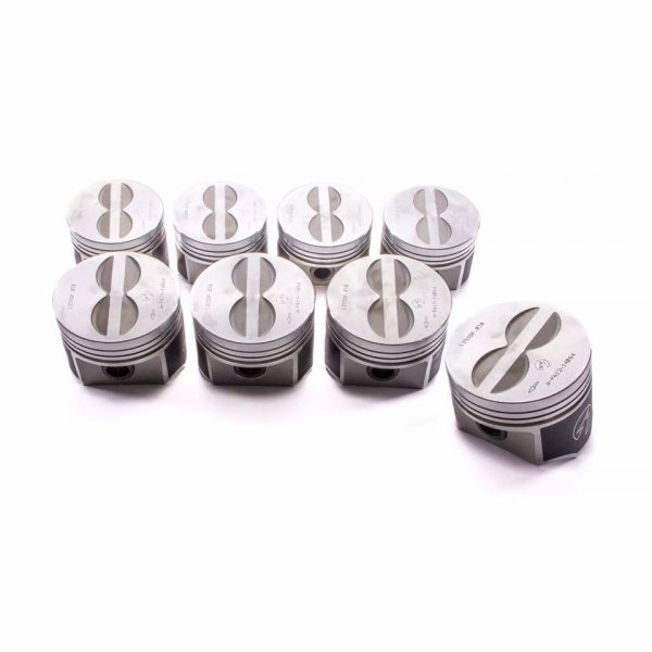

The 155 hole motor was the same 440 bottom I used to go 12.0s
