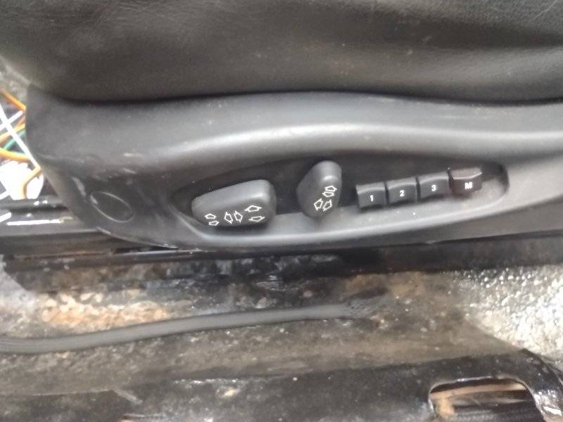

Bench seat came with the lap belts. Steel dash always was staring at me. So BMW E46 convertible seats with integrated 3 point seat belts installed. Seat mounting complete. Need to run a hot to both seats and ground to floor. Pretty happy with fit. Head rest height is even electric. Pull out calf support and manual flip forward. Not able to sort heated seat part though. These are heavier than your mother with all the electric motors.

Looked at the Chrysler seats. Issue with the locking in accident of belts. Lots on the seat swaps on the promod forum
Issue is with the electric inertia sensor/ trigger.​
