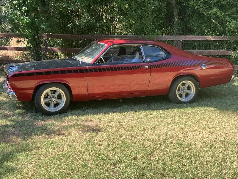

This Duster was painted in 2011 and has been outside for most of the time since then.
I will need to repaint it though. It has a huge abundance of chips in the paint from me stupidly running the weed eater too close to it. There could be hundreds of chips to fill so I’m looking at at least 2 costs of color over the whole thing just to blend.

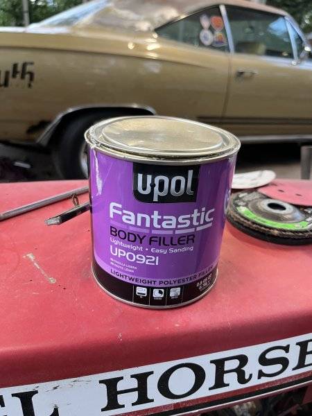

This is what I bought. I have zero experience with anything, $15 on the shelf at Oreillys, works good as far as I can tell
