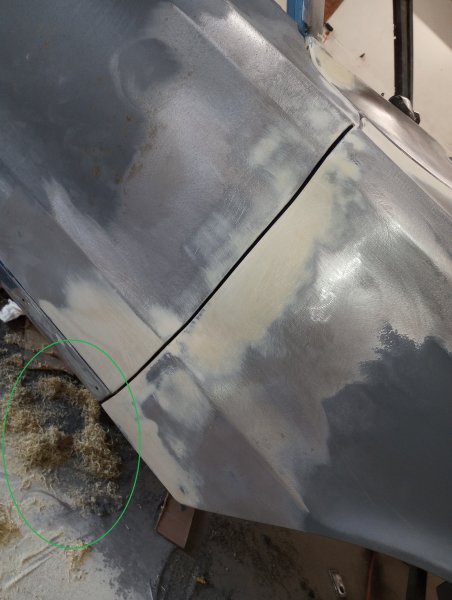

I never used a grater, i HATE bodywork more than anything.. so i'm learning as i go.. i put that stuff on then take it down with 120 on a DA.. then add more cause i didn't do it right the first time.. i do that like 6 times then i get it good enough to block
I didn't even know they exist til a few days ago... I would like to eventually paint my whole car. but right now just doing panels as needed to get it on the roadcheese grater by hand will get you there in 2 layers, 3 if it's a deep dent........... and it'll be straight
I'll ad, I use it with my hands..... there is no sort of "holding" tool required
you have to mix your filler so it doesn't get too hard too fast......... don't bite off too big an area, you have a few minutes where it actually grates like cheese
hard filler will dull the blade, gummy filler will clog it

I tried a grater, but it was on hard mud. I can imagine the difference. Can see where using a tool might encourage the use of too much pressure. I do my final sanding with a wooden stick and finger tips for a light touch.any of you guys use a cheese grater? I do 95% of my filler work with one........... followed with 36 on a board or a block, followed up with 100-ish and a skim coat of glaze....... very little sanding.
If I walked in on someone making a huge cloud of dust with some sort of air sander, I would fire them........ notice the fresh mozzarella
