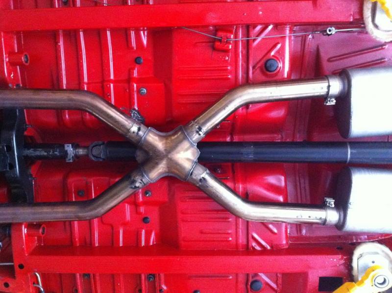

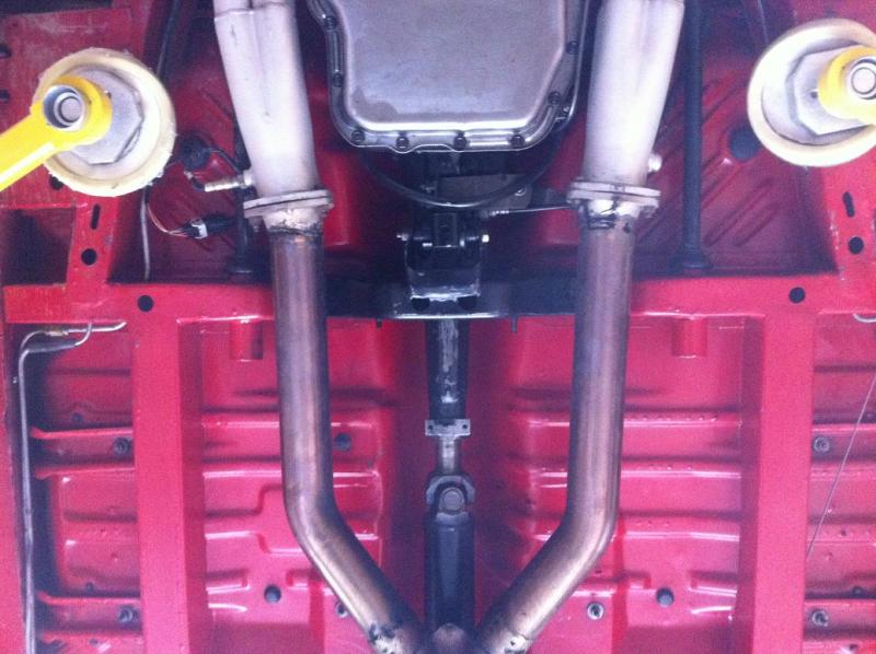

My Charger was not undercoated when new and the floor pans looked really nice when I got the car in 2000. I know that they are not supposed to be fully painted but I love the look.
