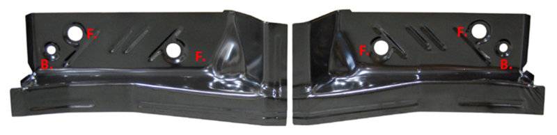

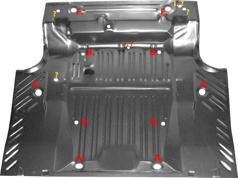

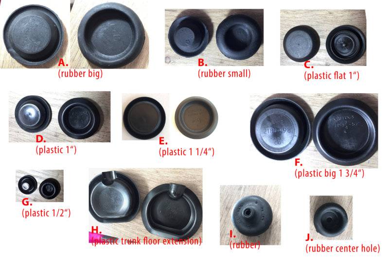

I've spent quite some time searching for the right body plugs and their locations. The answers here and over dodgecharger.com didn't satisfy me in every part yet, so I try to visualize as simple as possible and I am still not sure about all.
If you purchase the Mopar licensed "mega body plug kit" you will get mostly these plugs (a few are unique).
Uncertain plugs are marked yellow. Mainly I have difficulties to find the right hole for plug E. vs D.

Trunk

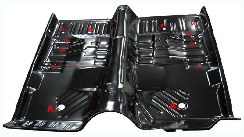

Front Floor
Rear Footwell Area

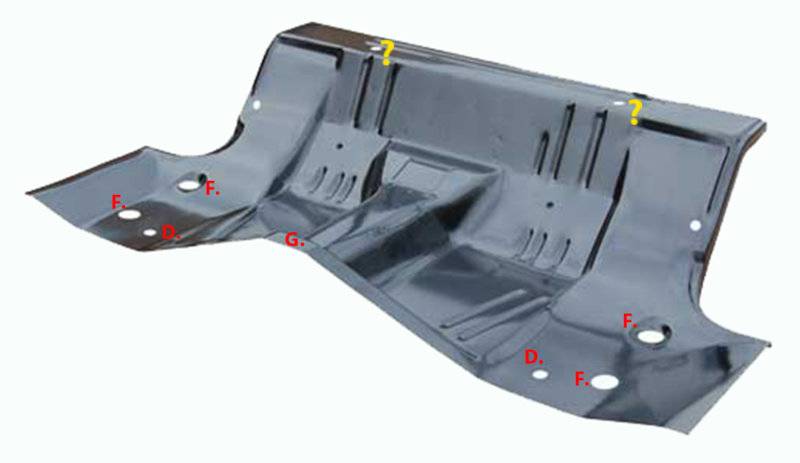

Rear Floor

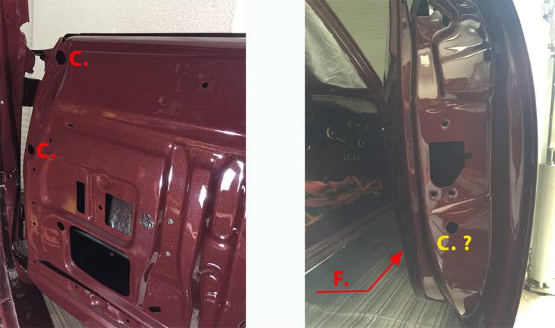

Door
Rockers get each side 2x D. (plastic 1")
Maybe fire wall plugs ? I believe some are there too.
I believe j is for gas gauge wire. I is
Firewall Grommet for the Speedo Cable, Shaker Hood Cable, and Trunk Vent Tube.Last pic of door I think is a c
I agree with you, plug I.: trunk vent line and speedo cable.
Isn't plug J for the wire that goes inside the car and then out through the trunk to the tank sending unit? That is what came on my mind, this hole is smaller than all the others.
And where do E plugs go? I have only 2x E plugs in my set. I think they will be somewhere in the trunk hump area over the rear axle?
yes -j- is for sending unit. not sure on -e-plug

On the 67 coronet there are two small ones , one on each rocker at the front.
im thinking some cars have more or less holes.
