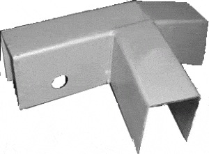

The car has 43,000 original miles and is pretty clean underneath (I had it inspected when I bought it). I am going to install a Hemi (600 hp +) 727 transmission, Dana rearend (Caltracs) and plan to run it on the street and race it on occasion. Weight is not my highest concern, a solid ride is. As I tend to be hard on stuff, my question is are there any advantages to adding Safe T Caps in the subframe torsion mount area, just to beef it up? Thanks Al

Its a Hardtop. The Safe T Caps I have run across at YearOne and US Car Tool. FRAME%20RAIL%20CAP.gif

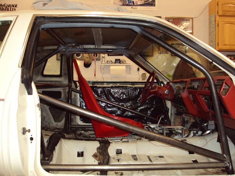

When I installed a 10 point cage in my Cordoba, I added a bar between the hoop and front down bars along the floor to stiffen the middle of the car.stiffener bar.jpg
