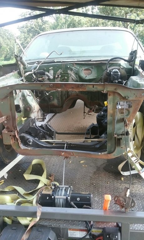

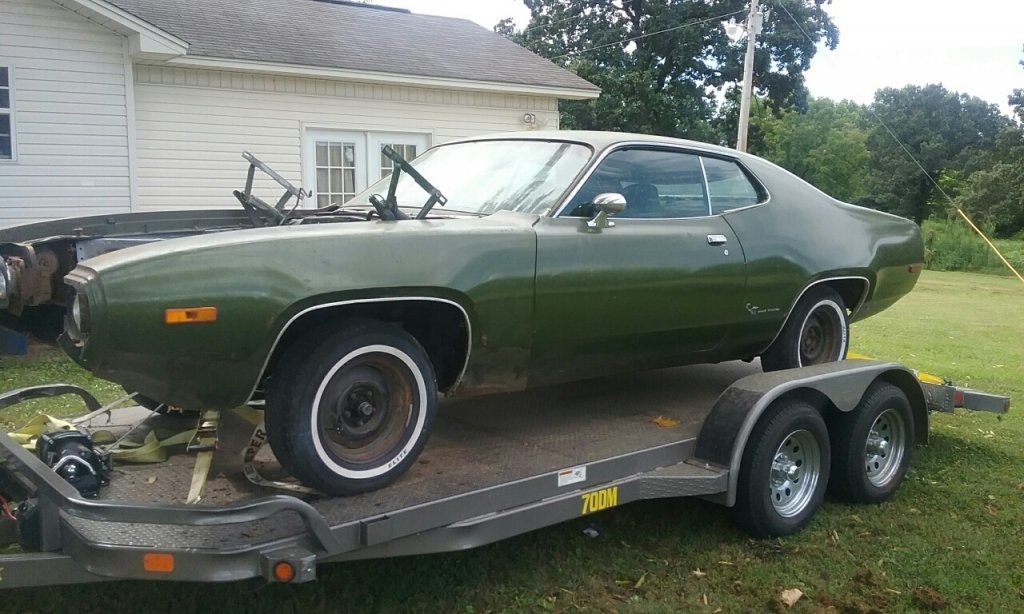

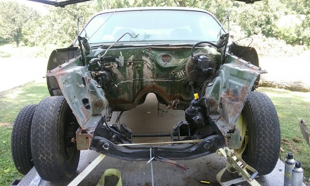

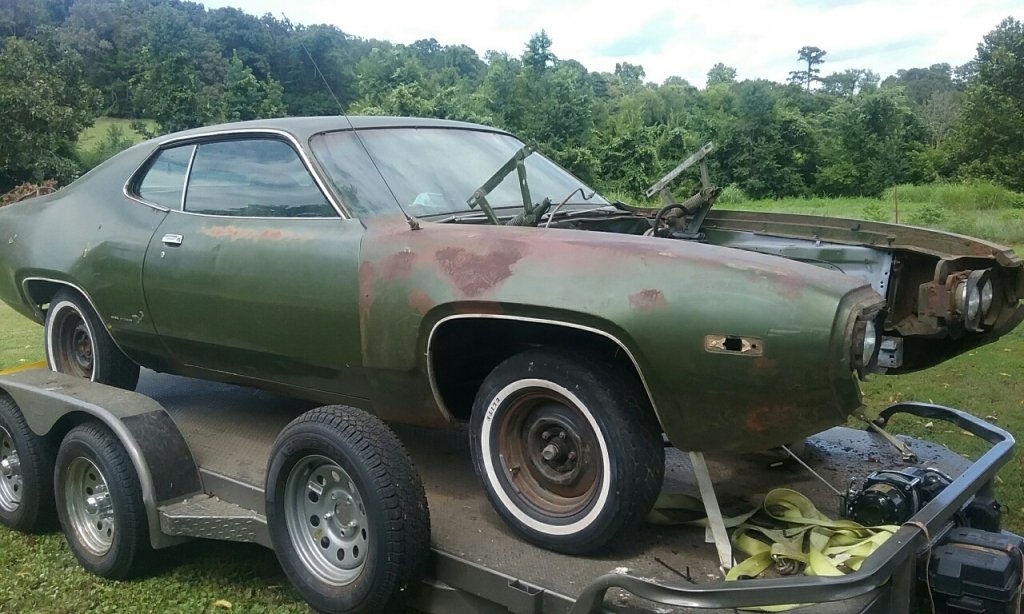

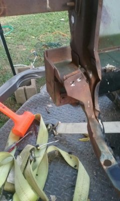

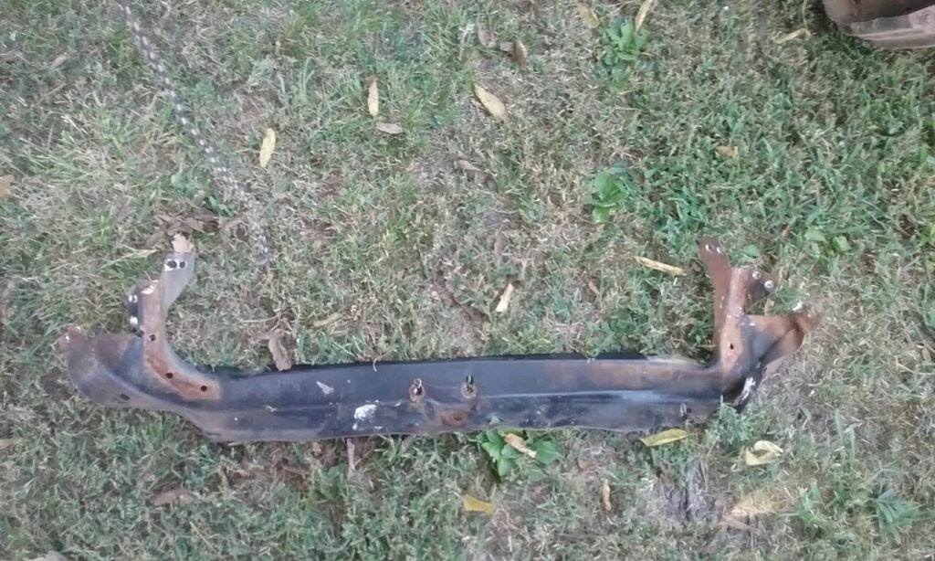

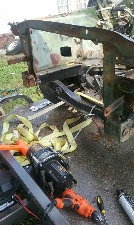

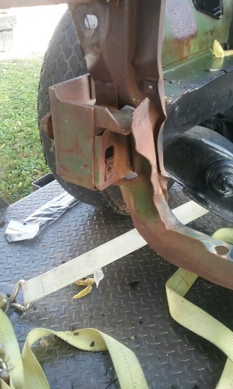

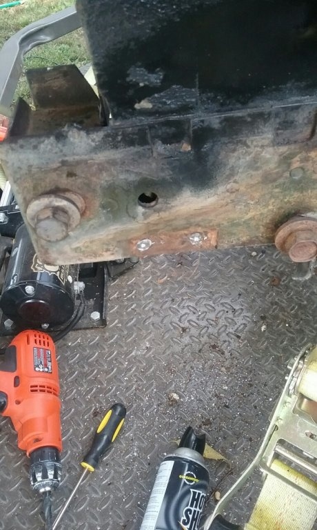

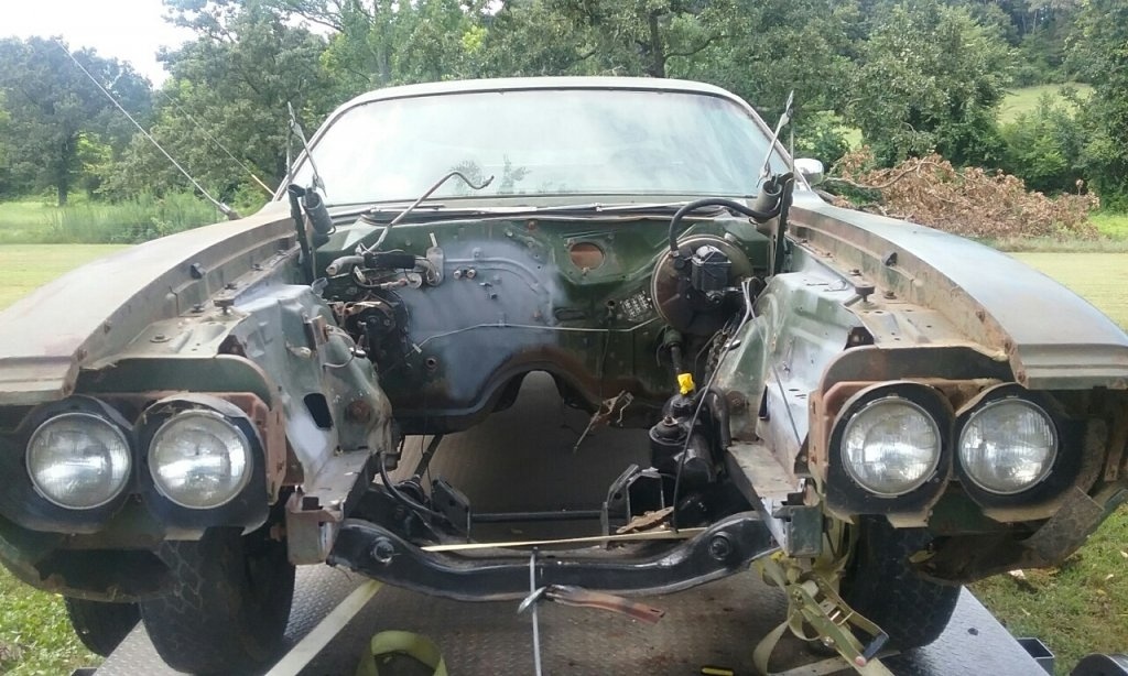

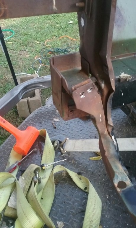

As promised, here are the pics of my progress this past weekend on the removal of the core support. It went a lot easier than I was planning, but that's not to say it was a total piece of cake. A lot of spot weld cutting and banging went on before I figured the easiest way for me to do it. I am glad that it is done now. I left the car on my trailer when I did this b\c it was sitting at a good height in order to work without stooping over the whole time. I did have to straighten the inner fenders a little because the passenger side got pulled in a little when car nearly came off trailer earlier this year. No biggie, lined it up and checked fit with fender, and got her back to where she was ( was only pulled in by half an inch roughly). This weekend, I will more than likely tackle the rear quarter patch prep and possibly the rocker. I am getting things ready so when I hopefully bribe a friend of mine to do the welding, it will be ready to go.

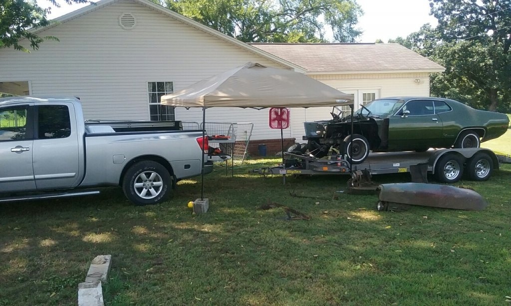

Here are a couple of pics with the fenders back on (checking for straightness) and my "mobile shop" setup. Don't laugh too hard at my ingenuity. lol

If you look at the passenger side pic (#2) you can just make out the pushed in passenger rocker. Kinda funny, my first 72 had the exact same damage on the driver's side. must of run over some Chevy parts or something. haha I am thinking (and would love feedback), instead of replacing entire rocker (which I have full replacement) maybe measuring and cutting out only the spot that is damaged and fixing it. Thinking cut right below line where rocker meets bottom of door down to spot welds, remove welds and patch accordingly. What do ya'll think?
Also, same mode of attack on lower passenger quarter, just remove rusted out spot and replace with new metal as opposed to replacing whole lower. Comments?
IMOP I wouldn't cut the rocker out and fab on a new piece. As much as I can tell from the picture, it don't look bad. I'd buy one of these and pull it out http://www.eastwood.com/deluxe-stud-welder-dent-pulling-system.html They or other companies also have a dent puller (?) to help be like leverage when pulling big dents out and might give you better control while pulling or can use a slide hammer.

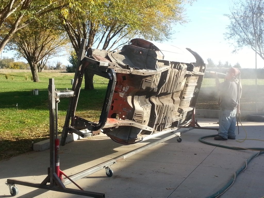

Depending on your intentions of the car and since you're this far in the tear down of it, you might as well go all the way tearing it down and go back. here's mine
I like your setup there. I thought about a complete tear down but, when I found her, I was fairly careful and crawled all over her from top to bottom, inside and out. The only "floor pan" issues is a small hole the size of your pinky nail in trunk. The rest of floors are shiny green on inside and looks to be a dealer (?) undercoat on the underside of car. If it weren't for the headliner stitches being popped, the interior is a solid driver in quality. The only body issues are the ones I have posted. My first 72 taught me what to look out for. I am lucky to have her and for her to be in as good of shape as she is.
