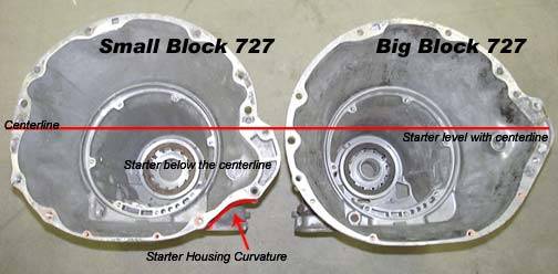

Whats the difference in a small block 727 vs a big block 727? Could this be the problem?
