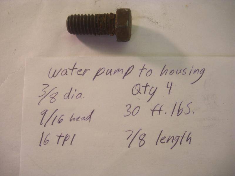

Found a cool thread , no pun - Someone did some hard work on A Bodies forum
Says bolt head not included in length
