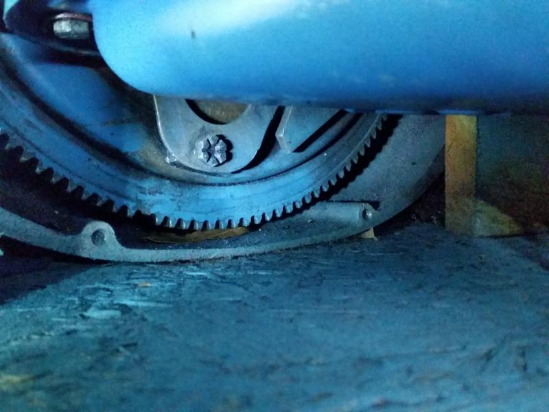

Here is a pic from my 383 the heads are grooved, like you said, and they are a larger size than usual 5/16 bolts. The head is not as thick as typical 5/16 bolts....
